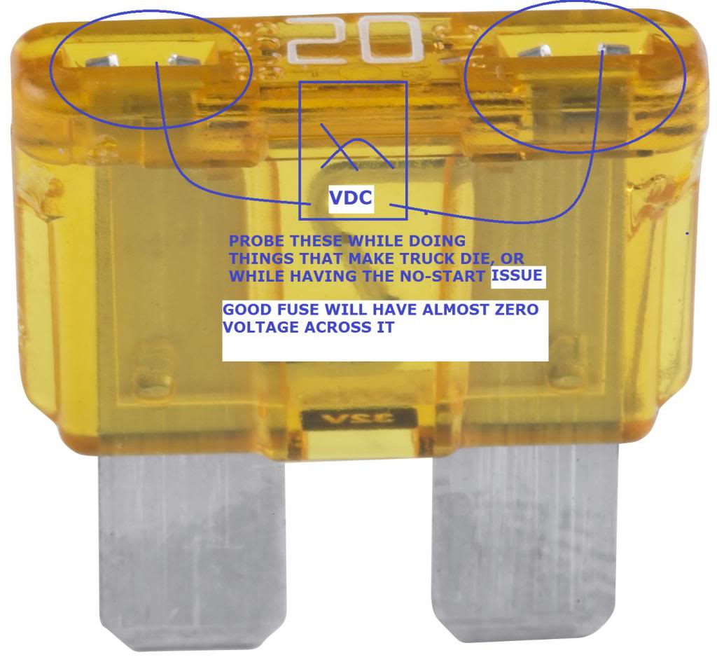

Another simple thing you might want to consider:
A fuse may look OK visually. It may even pass a resistance check. However, a defect may cause it to have intermittent contact or heat up and raise its resistance when current runs through it.
Look at you schematic for fuses that supply current to your ignition, EFI, and fuel pump systems, swap them with known good fuse of same value (i.e., horn, hazard, headlight, charge...). See if problem goes away.
If no fuse to swap with, probe voltage across suspect fuse while doing things you think make truck die, or while you're having issue. Good fuse should have almost zero volt across it even while carrying load current.
Good luck.
