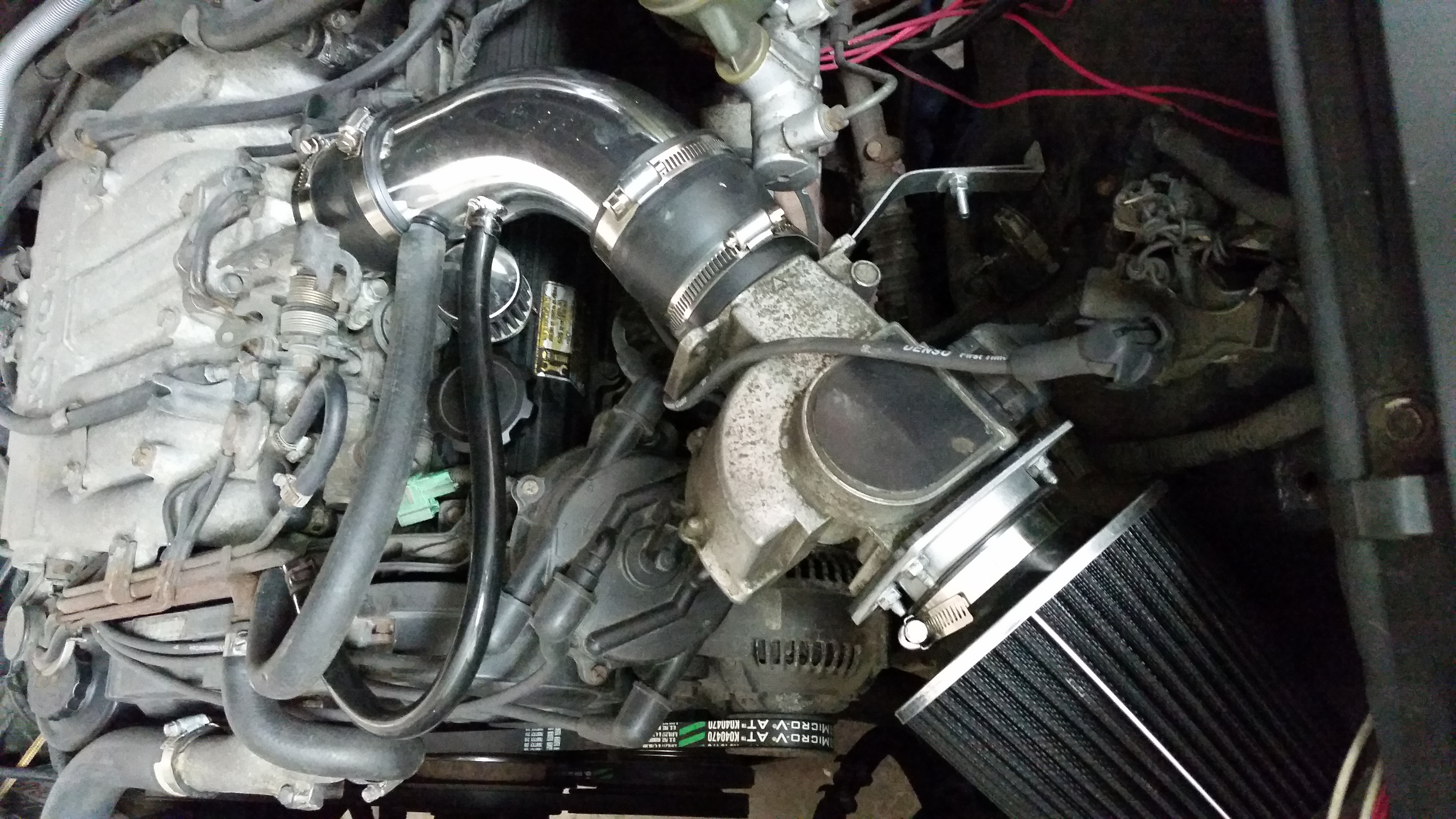

Old Jul 3, 2017 | 03:16 PM
Rachel Crowford's Avatar
Joined: Jun 2017
Posts: 16
Originally Posted by wyoming9
Just curious how you have the AFM plumbed into the new air intake ??
Here how I hooked it up...
Attached Thumbnails Can't throttle after cold air intake-20170703_185240.jpg   Can't throttle after cold air intake-20170703_185253.jpg   Can't throttle after cold air intake-20170703_185300.jpg

It is hard to tell and not having a 3.0 to look at are you sure your throttle cable is hooked up correct ??
Giving you the complete range of movement as the pedal is depressed .

Are all of your vacuum lines hooked up correctly? In the pictures you posted you have two hoses coming off the intake pipe, one going to the reed valve, but cant see where the other one is going to. When you re-installed your stock intake did you hook it all back up like before? One hose going to the reed valve, one to the EGR, and one going to the valve cover?
