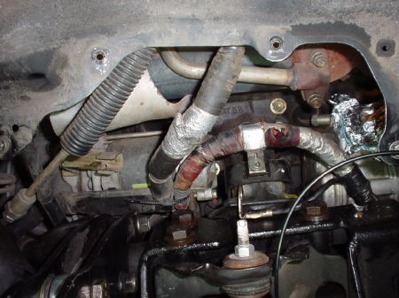

Yeah, the starter is what I'm going to try next....just one question: Where is it?

Passinger side between the bell housing and motor mount. Hint: It has a big cable and a small wire connected to it.

Well the good news is I found the starter, wow that thing is a PITA to get to. Anyway, my neighbor came over and we started talking, if it wouldn't pull/roll start then the starter wouldn't matter (just like gonzo said).
