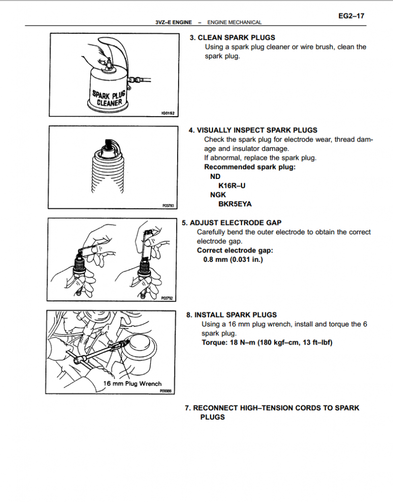

Um, both are copper core plugs.
Taken from NGK site: http://www.ngk.com/product.aspx?zpid=9325
"Most spark plugs contain a copper core for increased conductivity, improved heat control and improved resistance to fouling."
