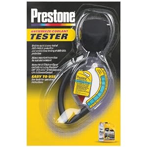

It's possible the corrosion protection chemicals might break down some in 3 years. I would test the pH. Mixed 50/50 with distilled water, Toyota Red should have a pH of 7.3 when measured with these papers:
http://cgi.ebay.com/ws/eBayISAPI.dll...m=110701564252
And test the specific gravity with one of these:
The freeze point of a 50/50 mix should be -34 F, but since antifreeze is not all ethylene glycol but contains about 3% corrosion inhibitors, the freeze point may be closer to -30 but shouldn't be much above.
If the pH and freeze point test okay, it's probably okay to use. But I would check the pH every six months or so, and replace when it gets to 7.0. You might consider using it for just a year or year and a half, instead of the full 2 years.
