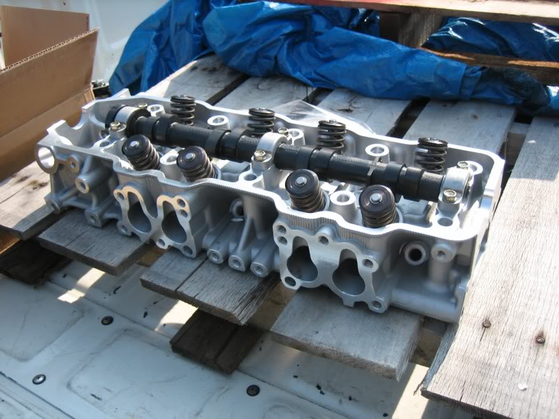

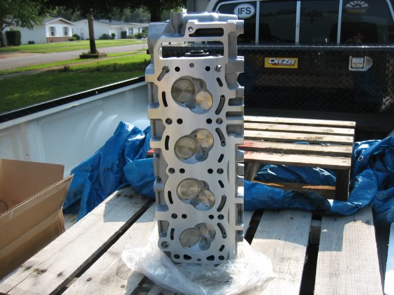

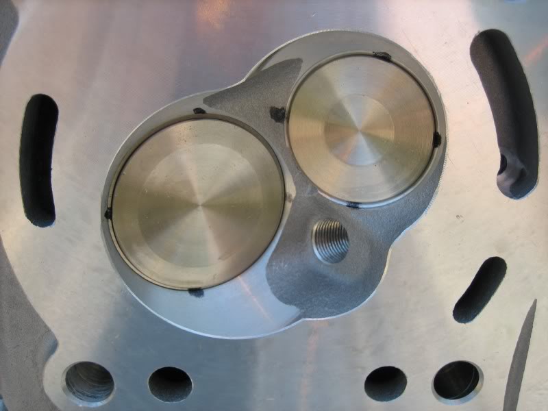

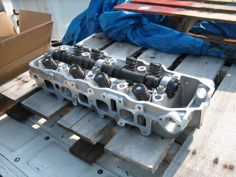

hey that looks familiar
I'm running engnbldr's Street/RV head and 261 cam, and the torque stays pretty stead and strong from about 2000 to 4500 RPMS; after that, it pretty much falls on it's face
I can't really say how it would improve on a stock motor just changing the head and cam out, as I installed mine as part of a ground-up rebuild
The majority of the specs of my engine are in my sig, but here's a glance of what's under the hood
