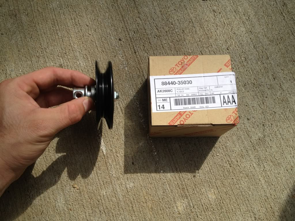

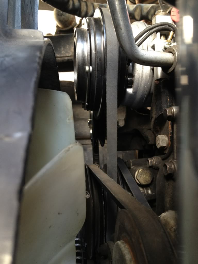

Well I went to the parts stores and they all tried to sell me the same part and they were all not the right size. Most of them show the 38036 as the right pulley but it is too large. I ended up giving the dealership a call and was able to get the OEM part for around $26 after tax and it came with the bolt and spacers. Part number was 88440-35030. You can find it online at several toyota parts dealers and it looked like ebay even had them. I have shown the pictures below for your reference.
