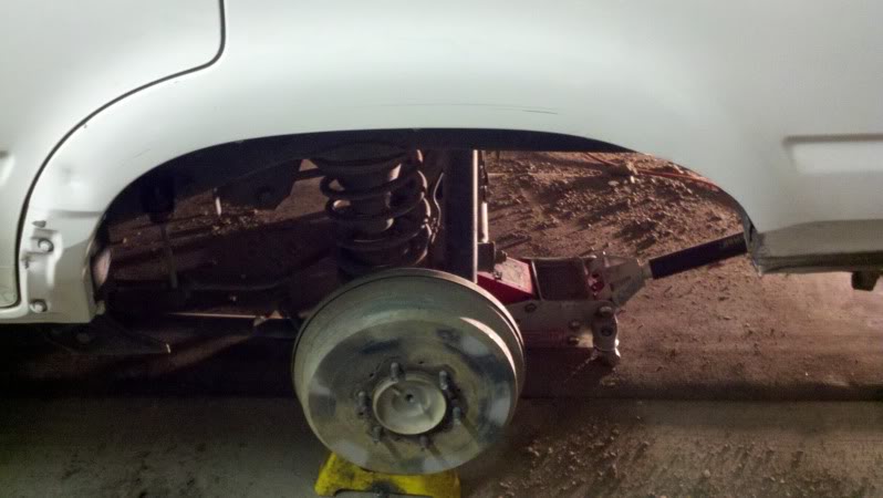

So then what about custom fitting the cut out flares to a second gen?? The first picture shows what I want but I wonder what they are from??
Old Mar 22, 2012 | 12:56 AM
nick89toy's Avatar
Joined: Sep 2010
Posts: 122
From: Moscow Idaho
those are from a 3rd gen pickup. They removed the factory rear bumper and filled in the the bottom section with a patch panel it looks like so that the back end is more like a pickup. What I'm going to be trying eventually is take a front set and flip them around and try to put them on the back. The rear wheel opening is VERY similar to the front wheel opening. Try it at tell me how it turns out

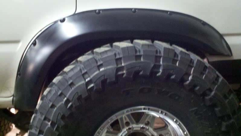

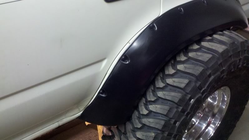

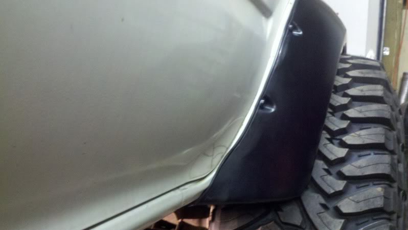

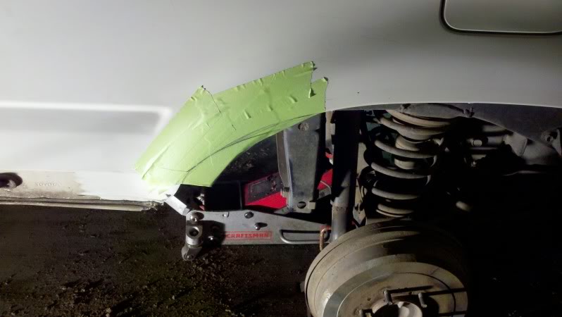

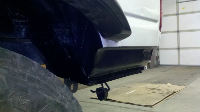

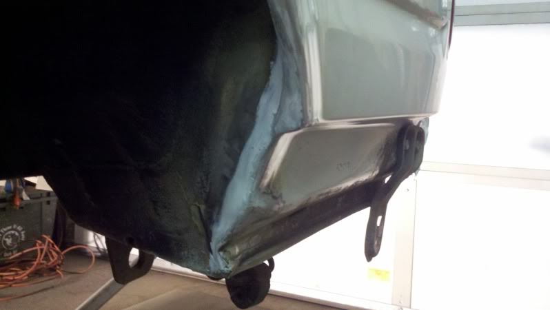

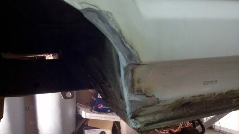

As I promised: Front 89-95 pickup flares flipped around and put on the back (front left goes to right rear)
If you are running big tires it will help if you cut out a couple inches out of the sheet metal on the back part of the fenders and If your axle is moved back a couple inches. I did trim the flares a little bit where they are by the rear door openings.

Old Apr 9, 2012 | 12:38 AM
Stuwy123's Avatar
Posts: 705
From: Calgary, AB
My hat goes off to you sir. Well done.
