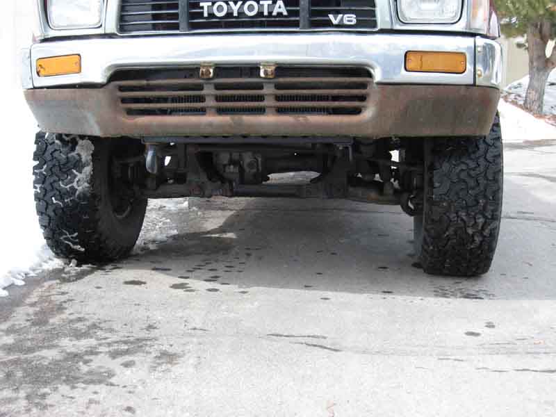

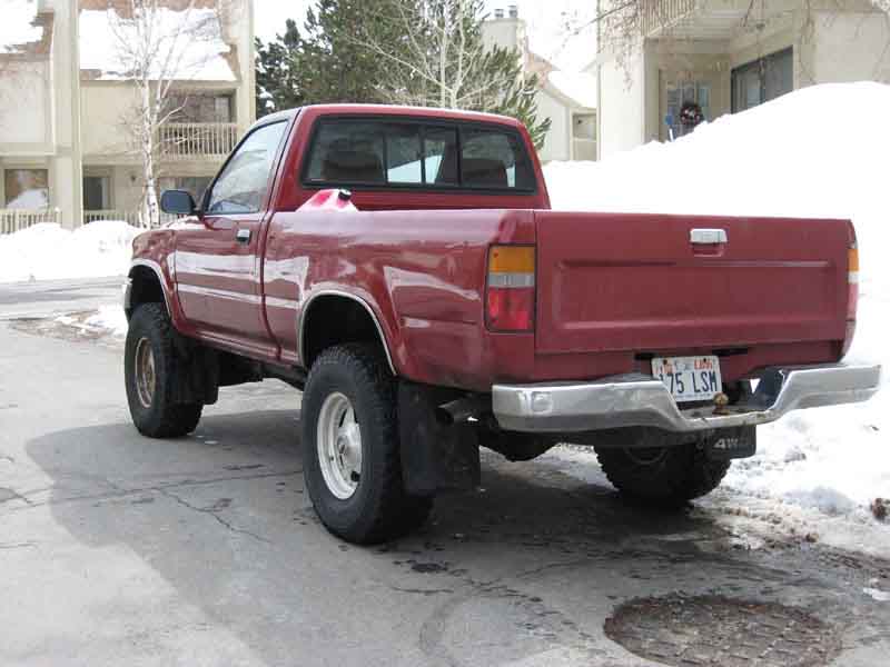

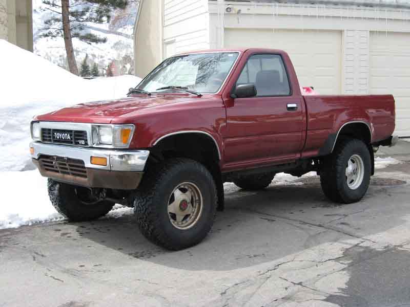

Here is the truck... Again, a 2" body lift and that's it 32" BFGs. Take a look at the front end and notice how relaxed it is (it is also covered in oil from the diff exploding which I will be replacing shortly...)
The shocks are old Rancho 5000s and the truck rides decent but more or less "like ass," really bounces around over bumps despite the springs seeming relatively soft. I wish it didn't have the body lift, this is about the ideal height I figure, not sure if it will be a PITA or not to remove the body lift...
I have quite a bit of experience with Old Man Emu, mostly from Land Cruisers. I agree about the soft shocks / stiff springs, so maybe I should go ahead and do Bilsteins up front... The issues with Bilstein is there is a stock and 3-4" lift shock and that is it.. I do not need high travel but am worried the stock length is not that good an idea? It also looks like the stock is a blue/yellow shock whereas the 5100s are a chrome color (and that is what they sell in the 3-4" lift range, it looks like only. So the stock shock doesn't seem to be a 5100. Not sure if that matters or not... )
