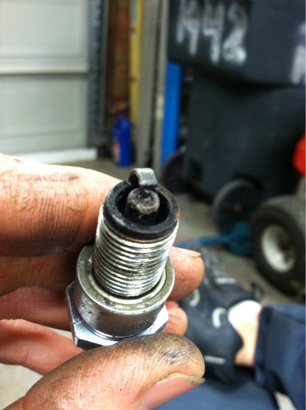

I have what looks like oil buildup on #1 cylinders spark plug.#2,3,and 4 look great.i just replaced the plugs about 300 miles ago.it isn't too bad it wasn't oily just kinda baked on. And my truck doesn't smoke any that I can see.i did a compression test and results were 160 on 2-4 and 165 on #1 which surprised me for having 178,000 miles on it.so it seems to me it would most Likely be the valve stem seals leaking.im pulling the head this weekend to replace the head gasket due to changing the timing chain without pulling the head it's leaking oil pretty bad were the timing cover meets the head.I am going to dissaemble the head and spec out the valve guilds and valves while im at it before i replace the seals .so what valve stem seals would u use? Felpro, Or oem?
Thanks

You are on the right track. Either seals will work. Usually the felpro ones are pretty tight. so if you have a guide that is a little loose, the seals will seal for a while. I would get a OEM head gasket though. Also check when you get the head gasket, the valve stem seals may come with it. I am not sure about that though.
Good luck.

Yeah I planned on the oem head gasket but was going to go felpro for intake and exhaust gaskets and it was cheaper to get the felpro upper engine gasket set online than to buy the 2 gaskets at local auto parts stores. I'm about 95% sure it's the valve seals leaking on #1 I seafoam soaked the pistons about 6 months ago to burn the carbon off them and the oil control rings and I looked into #1 with a flash light yesterday and saw a small burnt on pile of carbon on the top of the piston were the valve seal has to be dripping oil on the top of the piston when it's turned off hot and it hardens up on it

Well I got the job done last night and you wouldnt belive the build up on the valves from the leaking valve stem seals.It looks like seafoam I ran in it a few weeks ago cleaned the top of the pisons well but didnt even begin to touch the carbon buildup on the bottom of the valves.It looks like my truck has spent alot of its life idling the way thing were carboned up.The valve guilds and stems meaured within spec and the intake valves and seats looked great.The exhaust valve seats looked great but there was a little pitting on the exhaust valves but a little lapping cleaned them up pretty nice.I dont know if it was sucking air past the dried up valve stem seals or somewere else but when I got it running and timed it was idling 200 rpm lower than before.The valve seals were so cooked if you pressed then with your fingernail they fell apart.Im hoping for a little better gas milage after thoroughly cleanin the build up out of the head,in the combustion chamber,in the intake,and in the exhaust manifold with a wire wheel on a die grinder.Mitchell book time for the job was 6 hours and it took me 8 hours having to dissasemble the head and measure out and clean everything.Oh and if anyone needs a labor estimate let me know I have acess to mitchell on demand 5.
