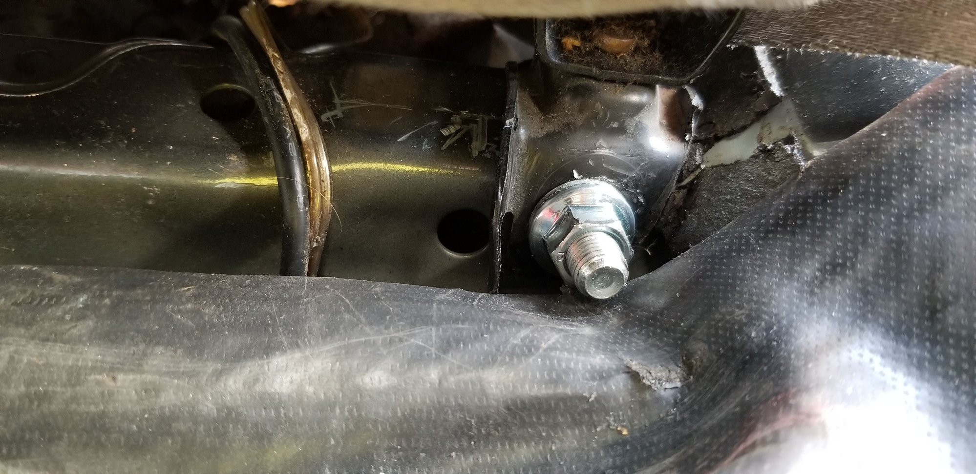

but then the holes would not come close to lining up. They are about an inch or more wider on each side. I drilled new holes and stuck a 10mm bolt through to use like a stud. I under drilled the holes so it would hold the bolts for me and I wouldn't need to put a wrench on the back side.

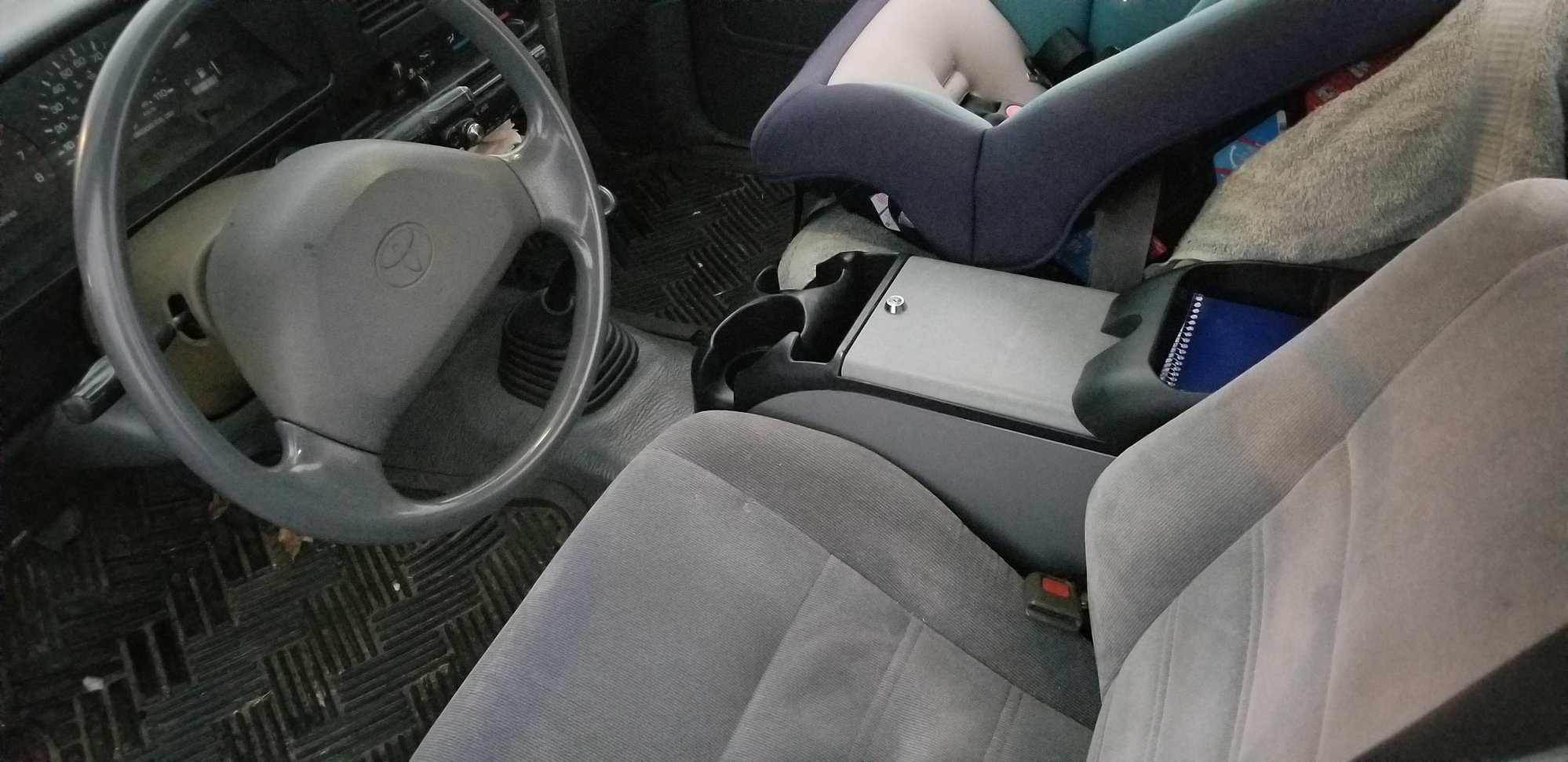

here is a before and after picture. The new seats are very comfy but there is some wobble in them with only 3 bolts.

I got my center console in. It is almost the right color. The interrior is a tiny bit darker grey. I had to run my seatbelts inside the plastic trim piece on the seats. The console barely fit and is very snug. I'm not going to bother bolting it in because its definitely not going anywhere. I may have to do something different in a year or two when I do a 4x4 conversion. I dont think a transfer case shifter will fit too well. But it will work well until the time comes.
