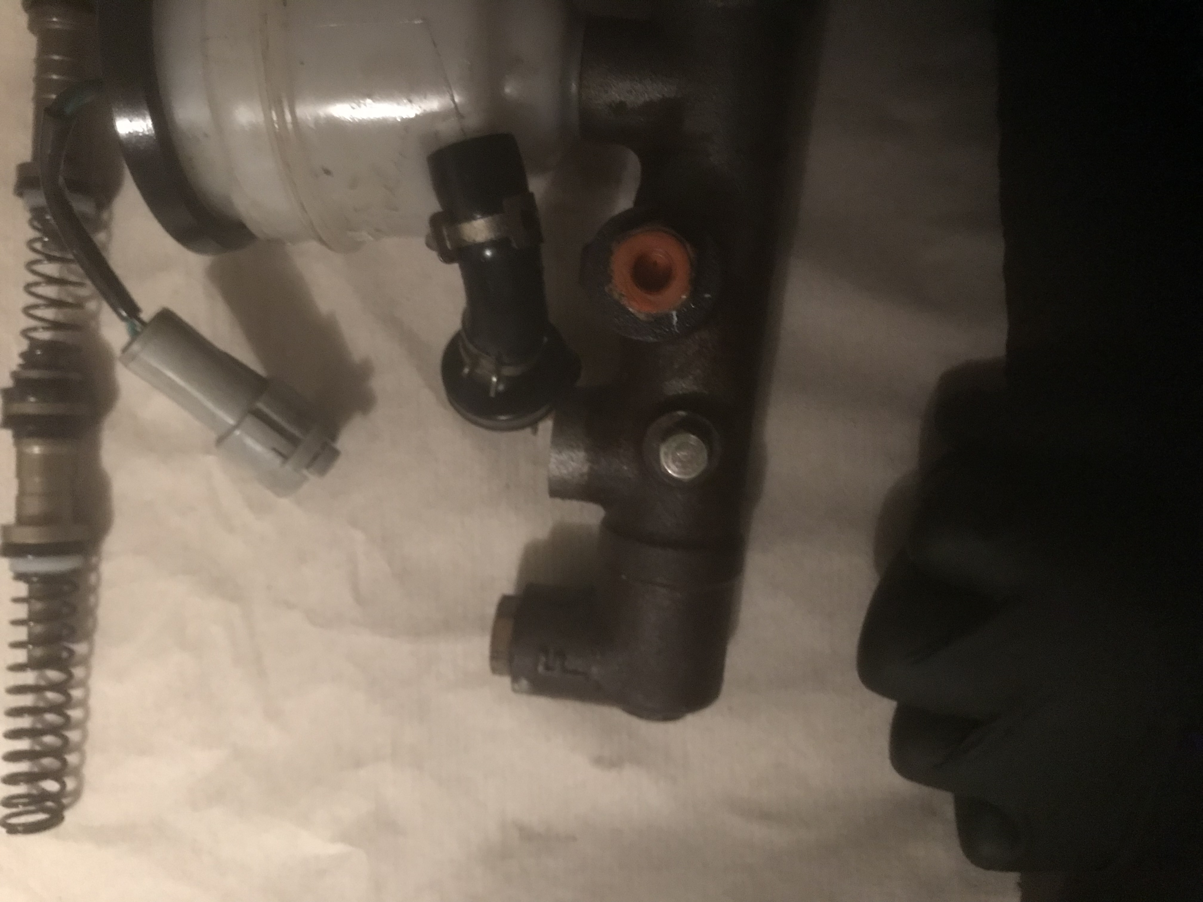

Did you remove the set bolt on the side or bottom of the master cylinder? That’s how you get the 2nd piston out. That and a little light tapping.
Attached Thumbnails Brake master cylinder-83e07684-f7e7-493c-b30e-a7bbc90dea4e.jpeg

Yes, thank you. Did not look like it interfered with piston?
