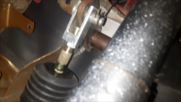

I made a snap of the rear end of my brake booster rod . I might get a sharper snap soon.
What is happening here? It appears to me that a threaded brass segment has become loose and backed out.
Second attempt to upload snap of rod.
Is something coming loose here?. Thanks for looking.

link to pic isn't working.

Blurry snap added above. The pedal linkage seems OK.
