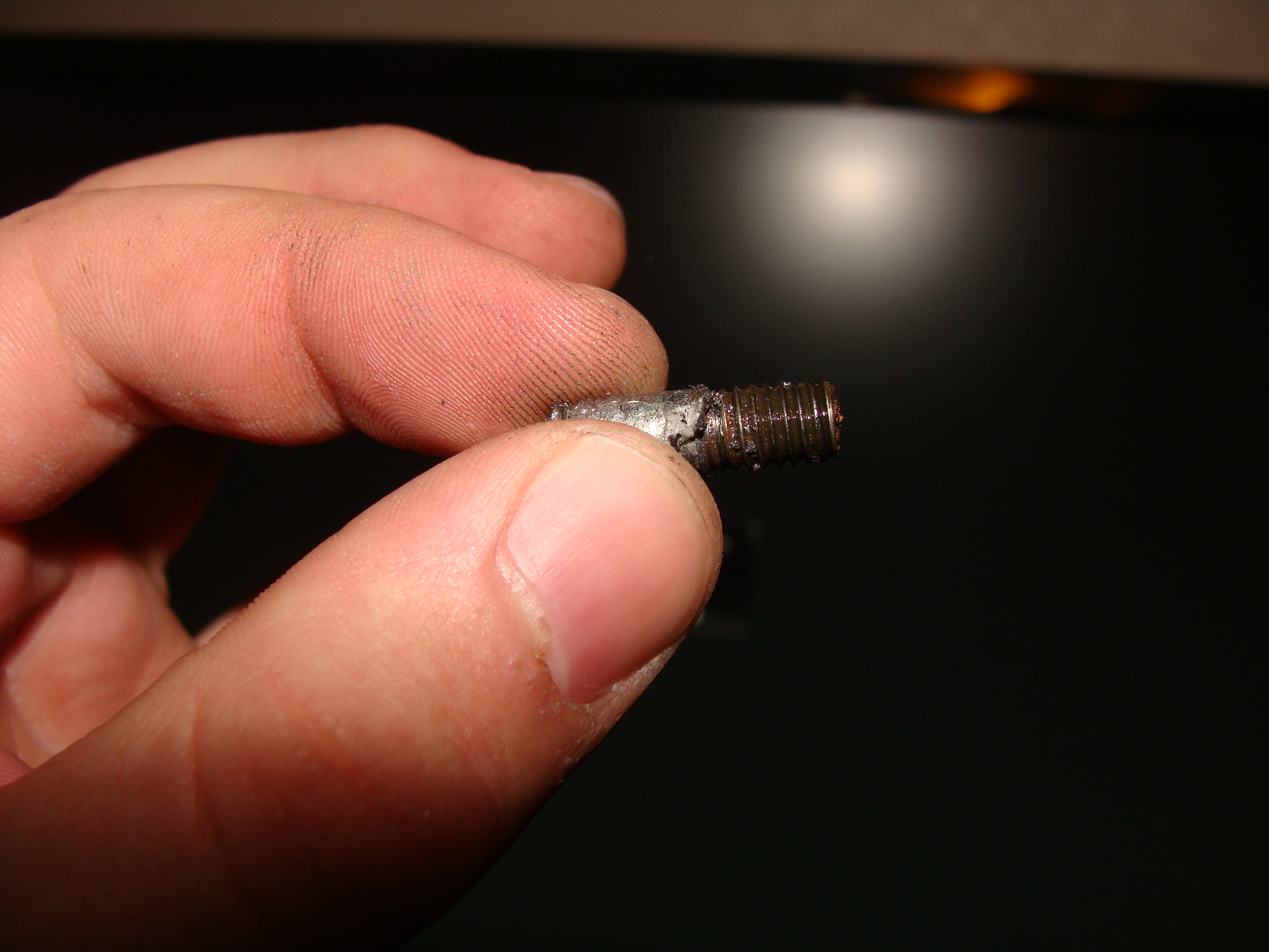

Old Mar 8, 2014 | 03:32 PM
twcolo's Avatar
Joined: Jul 2013
Posts: 16
From: Colorado Springs, Colorado
BEHOLD THE BEAST!
Thank you guys so much!

Glad you got it out without having to drill.
make sure to never seize the nuts on your new studs
