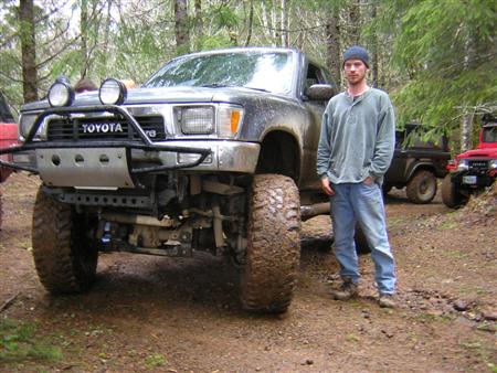

Bobakazi,
You did a 3inch BL right? Didn't you have to extend the steering shaft? Can you send me a bigger picture of your avitar? That is your truck right?
I wanted to get a better look at the skid plate on the front. I know on other toyota's that have a BL you can see the fron cross member of the frame. It looks like yours is covered.
Thanks
Email is Joeldotmiddleton@ge.com of course change dot to .
Old 04-26-2006, 12:21 PM
Bobakazi's Avatar
Join Date: Jan 2006
Location: Portland, OR
Posts: 378
Received 0 Likes on 0 Posts
I did install a 3" BL on my last truck, but that was 11 years ago, and I do not remember if I had to extend the steering shaft or not. The truck in my avitar is the one I have now, but I do not have a skid plate on it right now. I hope to get one soon. I am trying to see if Bud will make me one even though I was late on the group buy. I did not install the lifts on this truck, they were on it when I bought it. I can only assume when the last owner installed the suspension lift, he could not afford the longer skidplate. The stock plate will work fine with just a body lift. Here is a pic of the front how it is now. Sorry I can not be of more help. I am sure somebody else will be able to answer you.
