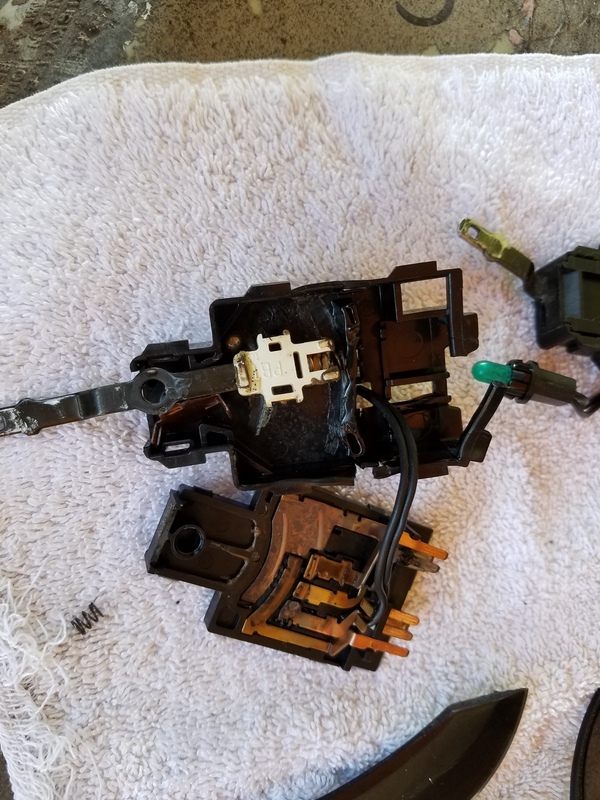

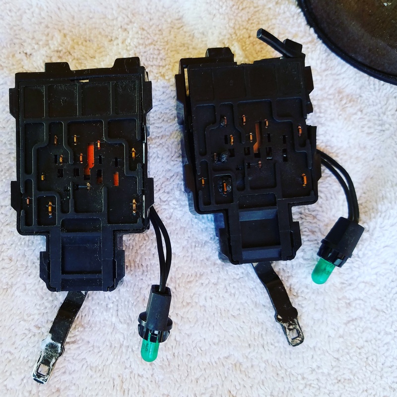

Could also be the switch in the dash, mine only worked on high speed. Switch has burned up due to a failed blower motor resistor
Below is copy and paste from my thread

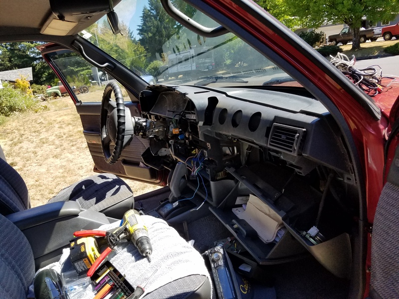

one of the things that bugged me when i decided to take on this project was that the fan had one speed, and no A/C. Pulled the dash parts boxes i had from the 4runner shell i had.
Found a good fan switch with the a/c controls and started to pull apart the dash. *
i was very happy:toilet3::wtf: to find evidence of a short
the new 4 speed switch is on the left and the one speed on the right, you can see some melting on the right switch
sure enough,the old switch had shorted for some reason in the past..probably the quality stereo install work*

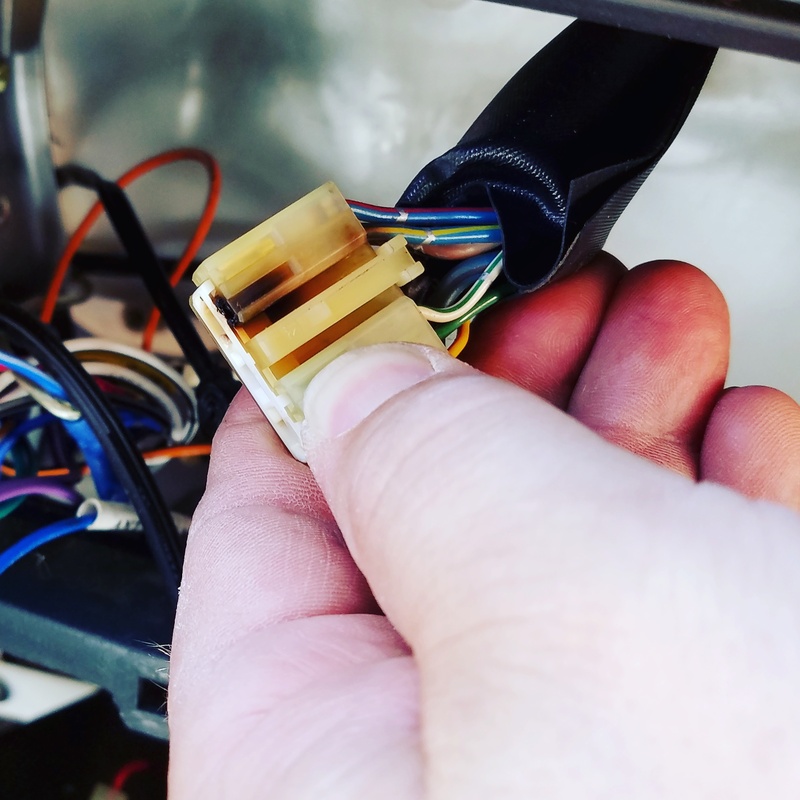

evidence of the quality that went into the stereo install, wiring from the Goodwill...
i hate leaving a project in this state but ran out of time
upside is now i have all fan speeds and working A/C

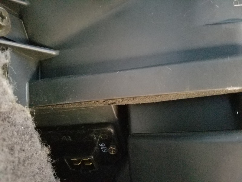

went ahead and replaced the blower motor resistor today.
I'd like to have a talk with the genious at Toyota who decided to put a failure prone point in such a convience place (tucked under the blower unit on the right side)
I went ahead and pulled the glove box hoping for a little more room.
got it out after a few minutes and cussing, not the easiest thing to get out.
if you need to having a 7mm wrench helps on the back screw/bolt, you can get to the visible screw with a screwdriver or nut driver.

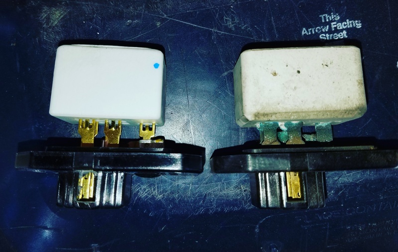

new one on the left, old one on the right..old one was slightly tarnished.
new one should offer a few years of good service

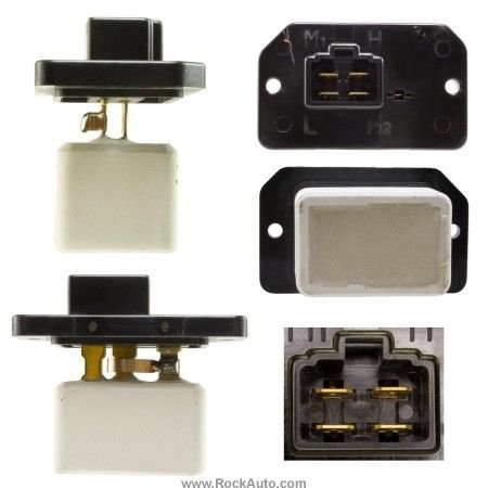

On a related note..
Originally Posted by dropzone
Originally Posted by magnet18
Does that later model much more robust resistor fit the 1st gen mount and plug? Seems it would/could have a higher lifespan with the full ceramic housing versus the goo method..
Edit.. answering half my own question since my old one is sitting here beside me. Looks like the same plug..

Check to make sure the resistor you replace it has the same amount of electrical contacts. There is a 3 prong and a 4 prong resistor and they will not interchange. A problem I had to trouble shoot the hard way and took a while. They look identical other then the number of contacts/prongs.
The 84-88 has a coil wire for a resistor and from what I have been seeing from others post, I am assuming the 89-95 has a ceramic resistor. Just to show why there are two types of resistors being shown in previous post.

Since I was there..
Since I was on the rockauto site and they do generally kick ass. I can finish answering my question about the resistor inter change..
No it's not going to fit without some rotozip..
