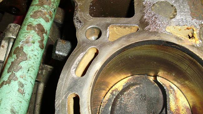

I was about to put a new head gasket (rock) and noticed how corroded this was around the water ports. they come pretty close the edge of the gasket seal as you can see.
I dont want to put on the heads like this, but thought id see what anyone else thinks...Im not sure if this warrants pulling the block and having it surfaced...ouch

and not where there is still gasket on the block...i know...its where I cleaned it up and its eaten out a little around the hole...

I would call them up and raise holy hell if it were me. If they 'rebuilt' that block (assuming I'm reading you correctly) there's NO WAY it should have that much crusty coolant in those passages after only 600 miles, and there's no way they should have let that block go with that much rotted out of the surface of those passages.
Chances are if you had to replace one of the heads (I'm assuming due to warping) then they were never truely 'flat' to begin with. I'd clean up the rest of your gaskets real good, and check the block with a straight edge and make sure it's good. With these engines, you only have iirc ten thousandths of an inch between both the head AND the block to play with to make sure both are ture and flat. If you have to take more than that off of it, then you're gonna have issues.
I'd get ahold of that company and express your frustrations with a 600 mile engine.

I have not had too many heads off...but I don't care for how this looks. Having the worn part around the ports may have been what caused this. I can't say 100% on this. I'm not sure if this can be ground down that much? I hope I'm wrong but I think you have some issues here... Any kind of warranty with this motor?

Raist hell and don't back off. Granted I'm a tech at a Toy dealership, but we could NEVER let something like that go back to the customer even after a regular HG job or V06 recall. That rig needs a block, plain and simple. I wouldn't run that with any kind of confidence that it would actually get me where I'm going... and the back home again. There's way too much rotted out of there, even after replacing the head gaskets, it's just gonna do it again. You could prolong it a bit with a better gasket, new head bolts, etc, but the HG's from toyota will run you about 75-100 bucks, and the list price on the headbolts are like 12 bucks a piece, and there are 16 of them! Plus the rest of the gaskets that will have to be replaced from tearing the engine back down again, the knock sensor pigtail (I don't care if the engine only has 600 miles on it, if I am in there, I'm putting a new one on while I'm there) and the aggrivation of having to deal with all this BS. I would raise hell and get everything in writing.
