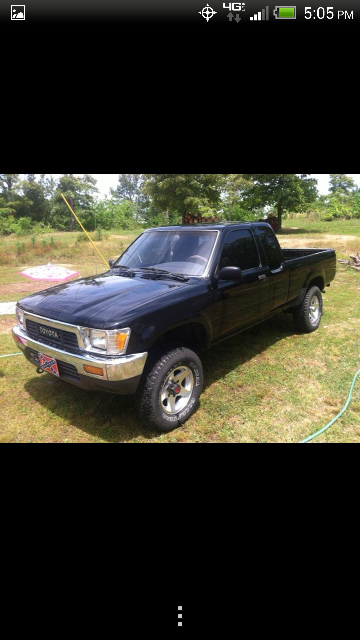

I did a service on my 1990 Toyota pickup. Its a 22re 4x4 with auto trans. I just did the service not a flush. My old fluid was black. What is that I sign of? I've never seen trans fluid turn black.
Attached Thumbnails black transmission fluid????-forumrunner_20131212_144540.png
