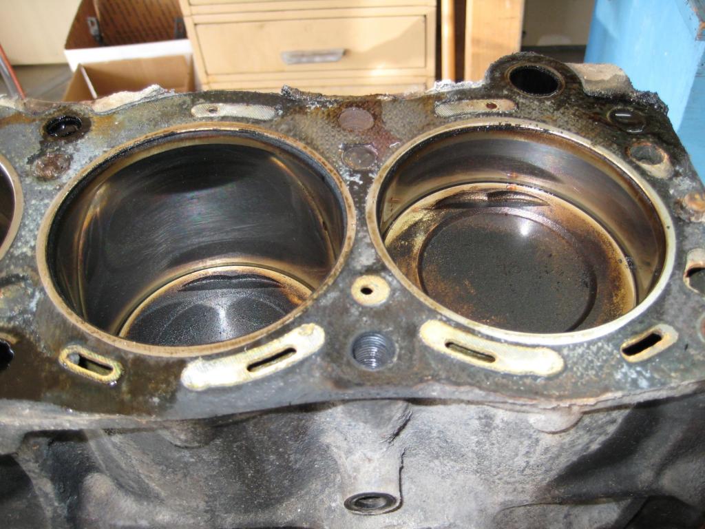

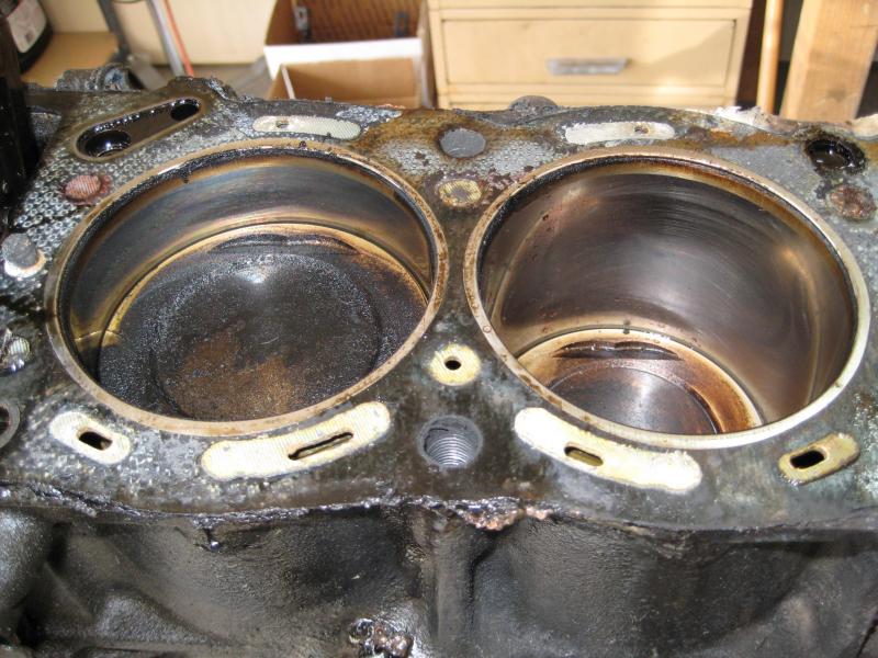

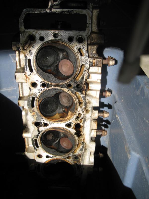

Well, I think I found the problem. Take a look at the pics and summarize for yourself. Now I have to determine why.

That looks normal to you? It looks I had some pretty serious oil blow by on every cylinder. I have never seen cylinder walls so dark. Nor head so carboned up. The excessive oil consumption had to come from somewhere.
And it looks like piston rings not working correctly to me.
See the orange ring around the top of every piston?
That's oil varnish a sign of excessive blow-by.
"Wet" carbon clearly covers the top of the combustion chamber(Cylinder head/valves).
Definatly something going on in the cylinders.
Pistons, Rings, Clearances, Ect.
Overhaul time!
Overhaul time!

Kiroshu, I long suspected I may have installed the rings upside down. Probably got the compression readings that weren't indicative of this. But the oil consumption was. When I went up or down a steep incline the exhaust would smoke, and that was another thing that gave me a clue.
I have another block I'm building up for this truck. But maybe I could just get the bores honed, re-ring and use this one again.
What do you think?
What do you think?
I guess its all preference really. Its probably still a good core block for a rebuild. Assuming is way passed stock clearances. Verify bore is appropriate for machining and possible oversize. A machine shop can check measurements if needed.
