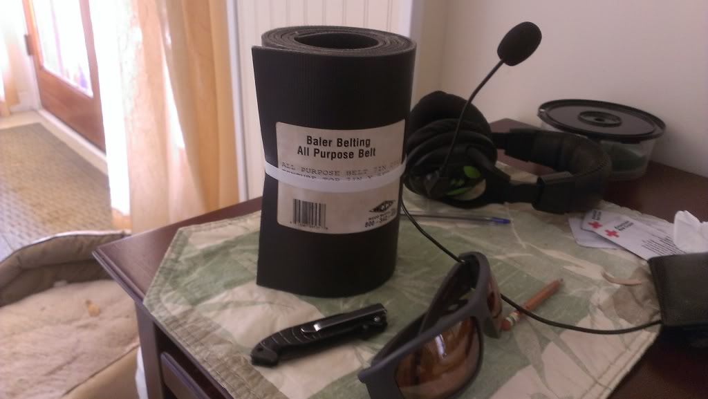

First up is material. I started looking around for some rubber sheeting type material and found this at tractor supply.Name:  IMAG0749.jpg
Its belting for a hay bailer, but i found that it would work perfectly. It comes in a varitey of sizes, this roll being 7 inches wide by 5 feet long. There was wider rolls but those cost upwards of $45, with this roll being $24. Is a hard but flexible rubber with 2 Ply construction, so its durable.

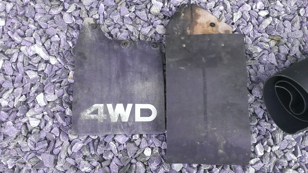

I cut it into 17 inch long strips, with the top 4 or so inchs behind the stock mounting plate. Heres the new flap compared to the old stock flap.

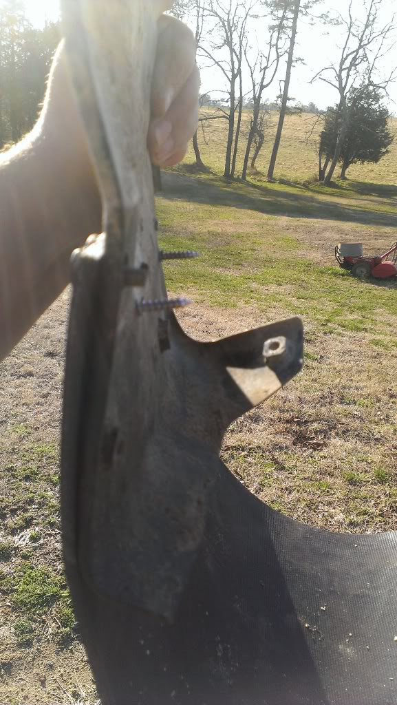

I just used plain self tapping sheet metal screws and loctite to attach them to the stock plate.

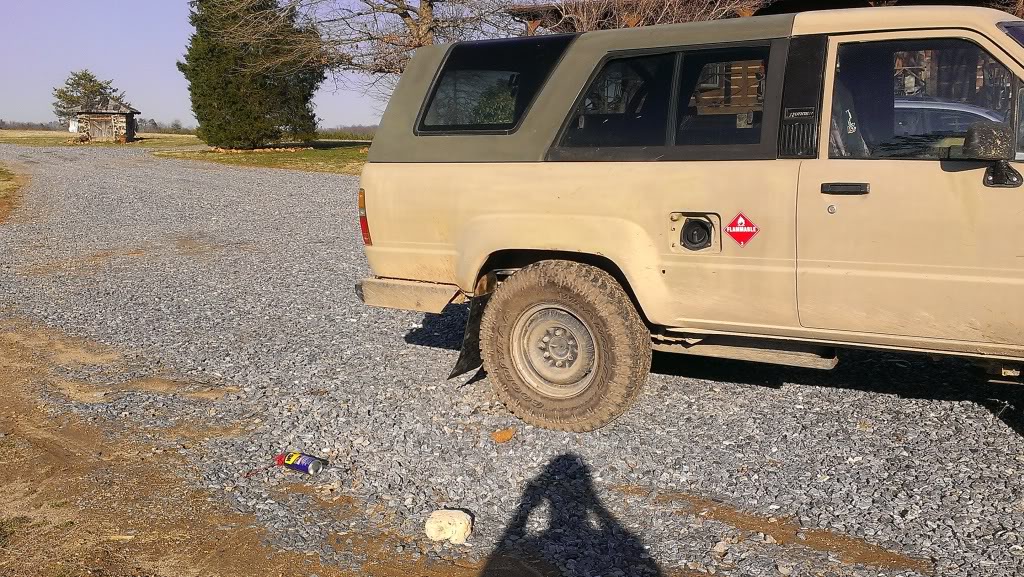

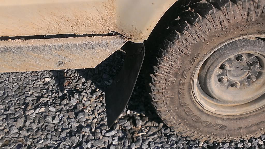

Heres how they look on the Runner.
Big improvement.

Not to hard to fix though, i'm just using sheet metal screws into the old mounting plate.

Already got em dirty.
