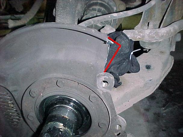

6: This is the only part that really requires some "customization". the dust sheild must be clearanced to fit the larger V6 calipers. You can either remove the plate and trim it with a hacksaw or really big tin snips, or just take a 4" grinder to as I chose to do.
The dust plate picture shows a slightly exagerated view of what material must be removed. Material must also be removed in the same spot on the bottem of the dust plate.
the Caliper mounts are the same, so just take off a bit at a time till they fit. Easy.

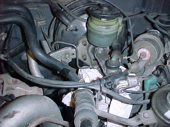

3: this is where you should learn from my mistake: REMOVE THE MC AND BRAKE BOOSTER SEPERATLY.
I removed them as a unit, and it was a pain in the ass. Don't do it. Unbolt the 4 bolts on the brake booster the hold the MC in place. You will be left with 3 pieces: the MC, the BB and a small piece that bolts to the BB that also mounts the ports for the front brake lines, and that runs to the MC...I should have taken a picture here, but just believe me.
Now just pull the MC off, and wiggle it around a bit to get it around the wiring/vacuum lines.

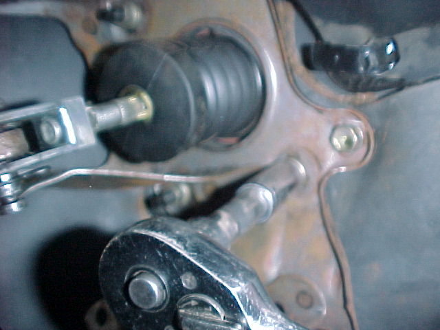

4: Unbolt the Brake booster. This is a bit of a pain aswell, as the bolts holding it inplace are under the dash. there are 4 nuts you need to remove that surround the push rod going to the brake pedal. You will need some patience toget these off, as there isn't much sweep , and you need some different length extensions.

The first picture shows the V6 MC and BB on the right, and the stock 4cyl MC and Turbo BB on the left.
the V6 MC is wider, and shorter, so should do the trick nicley. However, I noticed that the V6 BB is actually thinner, and wider than the stock Turbo BB. After some searching on pirate4x4, I decided to keep the stock BB. Plus because I have a turbo, I got a heat shield for my BB, so I don't know if it would fit on the larger diameter BB.
