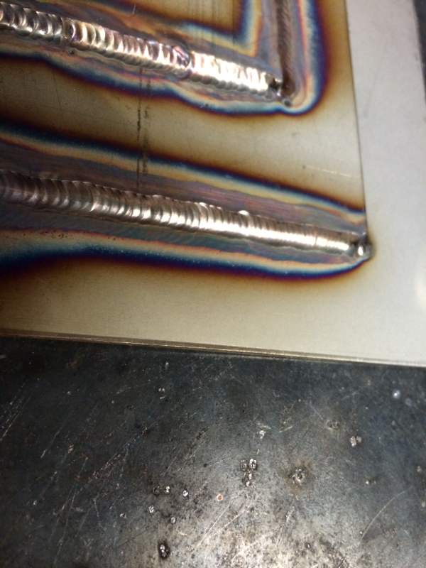

Yea in using hard wire and gas. That coloring is from tig welding and is completely normal. Although the heat affected zone is quite large I cannot turn my welder down any less it's at 10 amps

Your using DC straight Polarity with Straight Argon ??
Your prep work is perfect In Tig you can never get it to clean .
Poor fit up will ruin any Tigweld
Just not enough experience !!
Your HAZ in Tig should be smaller then all other processes
What size Tungsten ?? Is it to big for the material your welding
This is to much like work I go through this at least twice a day

Straight polarity straight argon cleaned it with brake cleen and a grinder. Yea probably poor fit up I've only had a tig for 3 months but I can run some pretty sweet beads maybe more experience but I think they're nice
3/32 tungsten ground vertically and sanded smooth
Was thinking of trying to do it like they weld razor blades together on dc+. Not dc-
