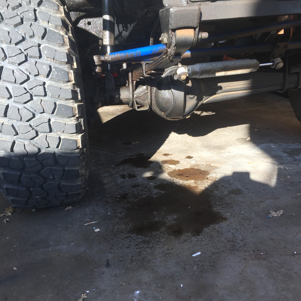

The 4Runner isn't daily driven, but this is how bad it leaks:

A leak that size should be traced relatively easily, no?

Yeah, it's leaking from the pump. That's already been decided haha.
I might just opt for a different pump this time. I'll replace the lines this time as well.
