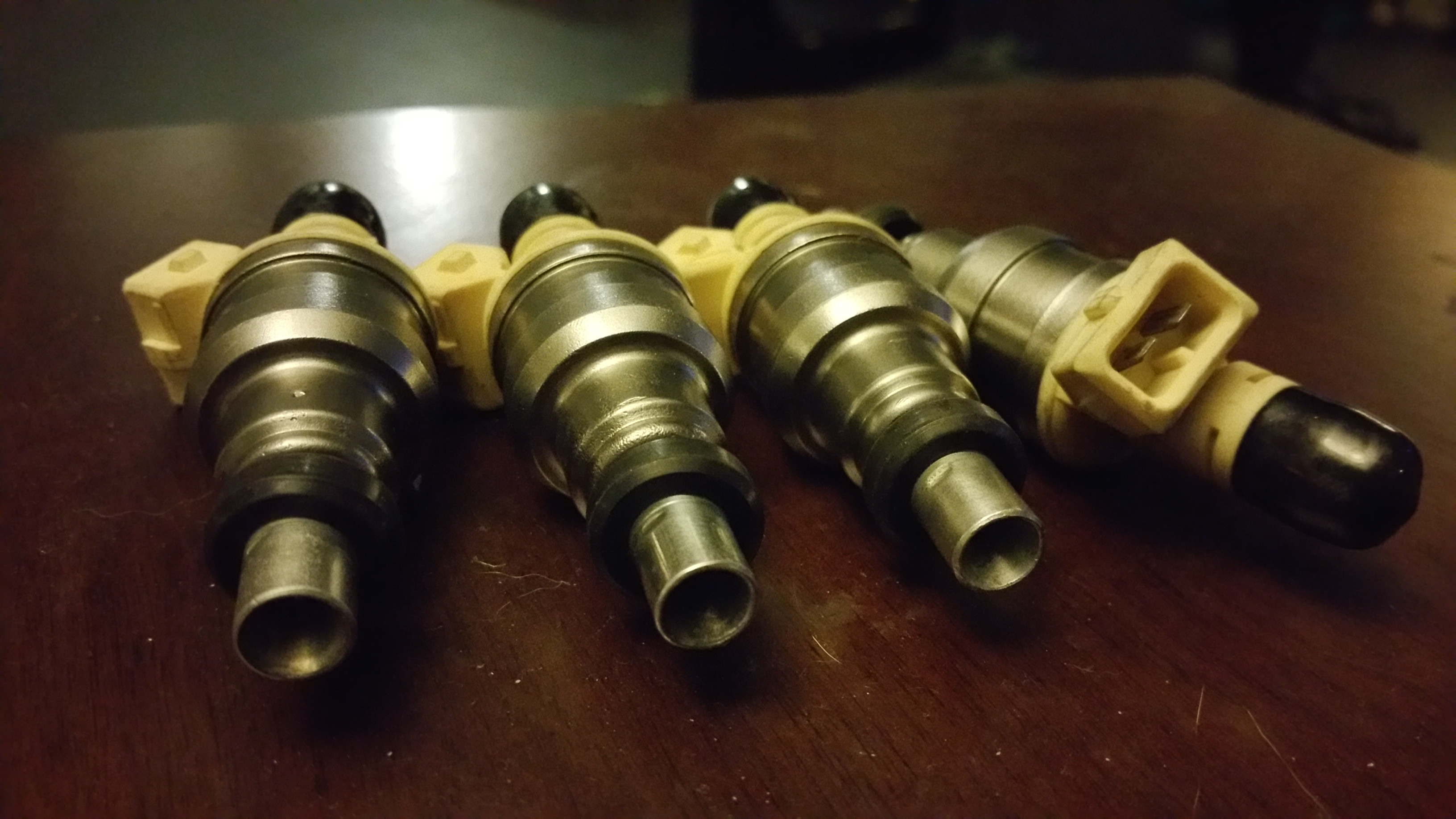

Well it may not be the best bang for the buck, but I am excited nonetheless
Just got my flamethrowers
Also have a new denso fuel pump eagerly awaiting installation tomorrow
