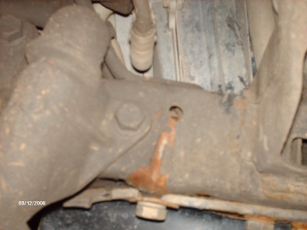

i took look at the frame and it is the frame not the mount , it is pushed in ,crushed together its only like a 1/2 - 1/4 inch

photos would help.

pics of frame

heating up a box frame like that would require removing 90% of the truck up front. The heat would boil the oil out of your steering gear box, and whatever else was near by that would absorb all the radiant heat from the torch and the hot metal, then you would still need a puller to move it. I 3rd or is it 4th the frame shop.

at the shop i used to work at, it was $40hr...and the job was like 20-30 hours (rough estimate) but it can get up there....I would say $400-1500!

This is one for a frame shop plus an alignment.
