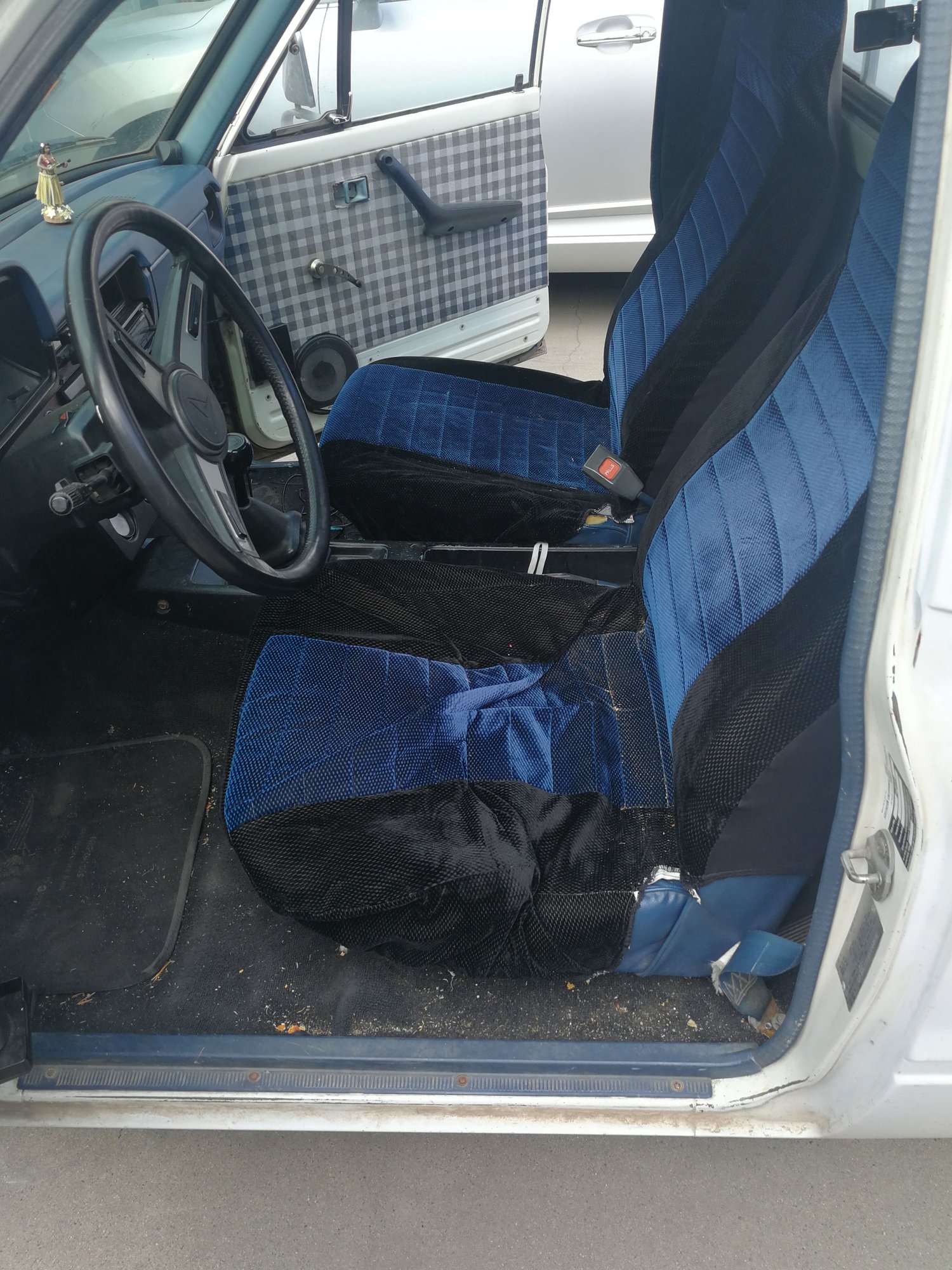

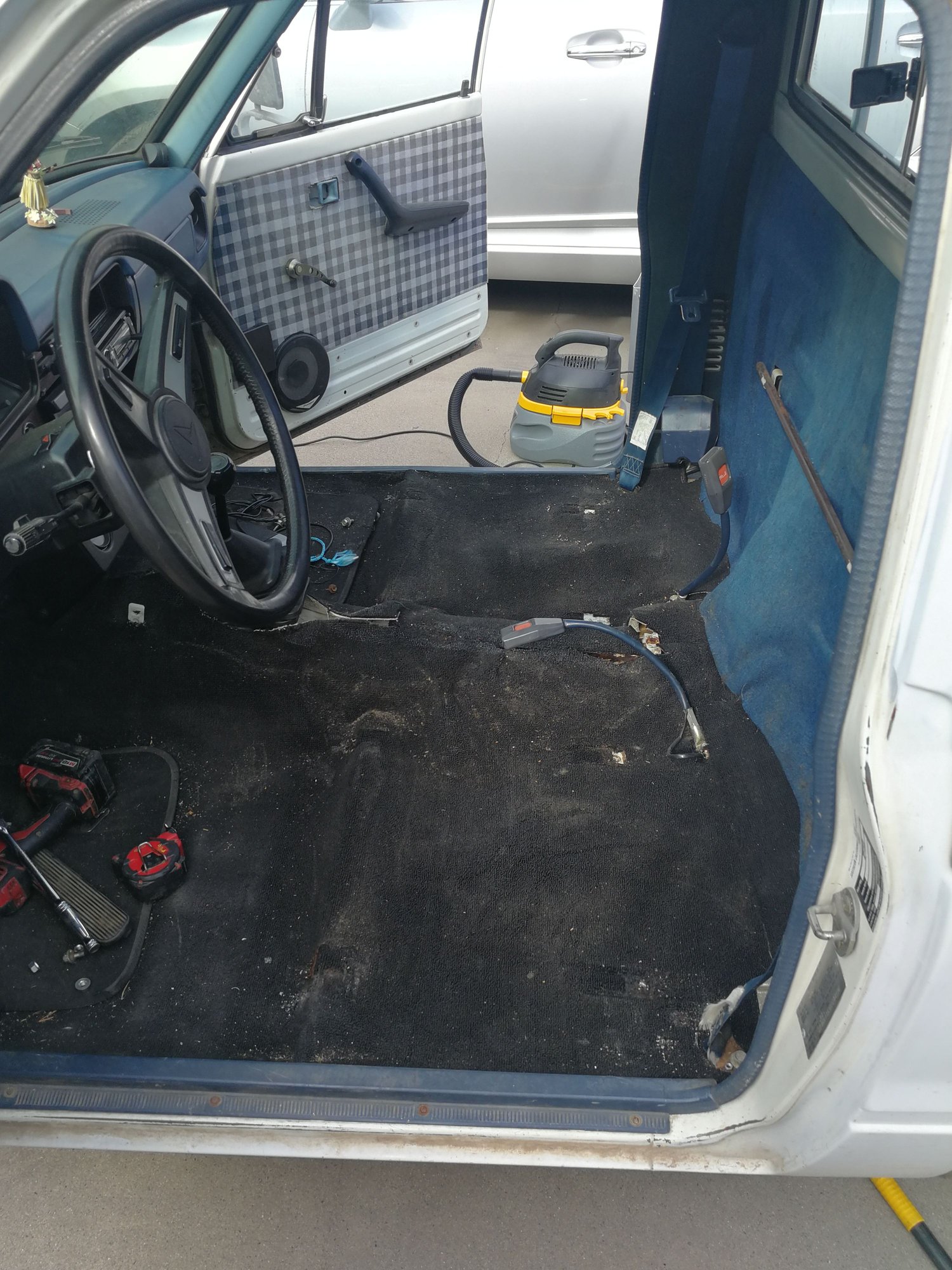

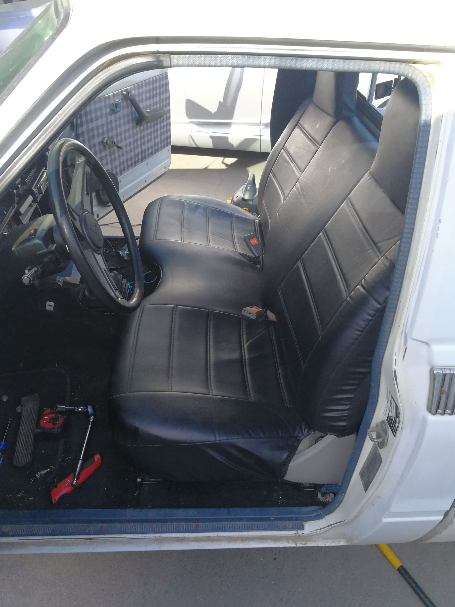

I put a bench from a mid 90s pickup into my 81, so I'm sure it would fit an 87. It was a little tight but with some wiggling it fit in the cab perfect. Bolt holes mostly lined up, I think I drill a couple new ones but realized after that I didn't have to, can't remember exactly. Whole swap took a couple hours including a deap cleaning. Way more comfortable than the old buckets

Found my before/during/after pics.
