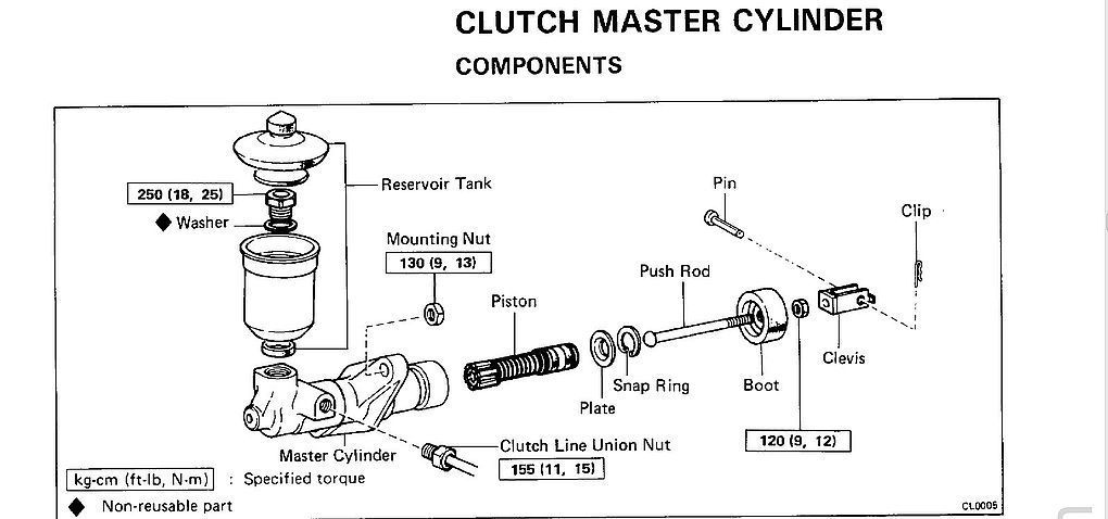

I've been wrong before, quite frequently, but I believe the OP was talking about the clutch MC, not the brake MC. Not much stopping power to the clutch
I've got 2 '87's, and neither of them has that cylindrical device at the end of the pushrod, where it connects to the pedal. Both of mine are as the one that Blueman posted.
The above picture is from the 86-89 FSM I have. I don't see the cylinder on the pushrod, where it connects to the pedal, you showed in your picture, Duane.
I suggest you go with the one Blueman posted instead.
Make sure you do the pedal and pushrod distances as the FSM specifies. Whatever version of the master cylinder you install.
