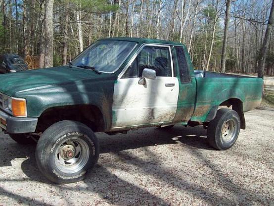

mine has a 92 bed and it bolts up fine, i didnt put it on, and it has some rear body work.

and my trucks an 88, cant poast pics for some reson but i have pics on my album

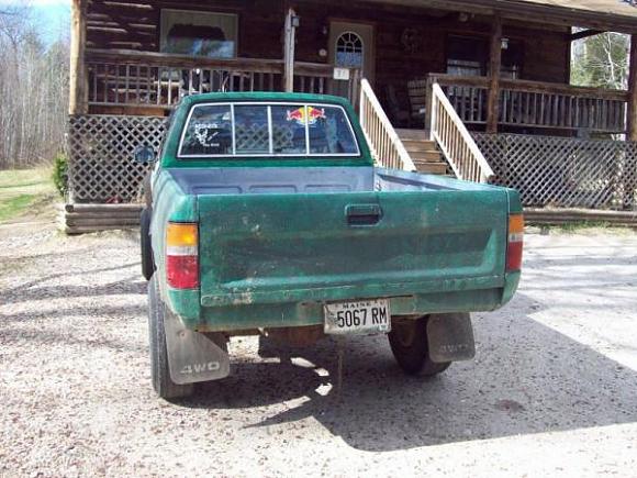

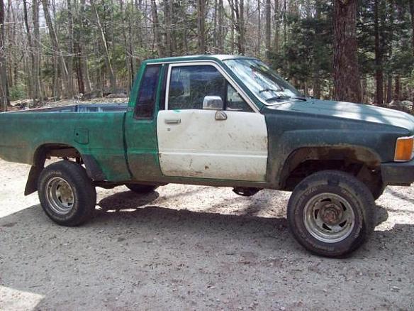

said invalid url but i got em up, had to re name them
Attached Thumbnails Bed compatability questions-user63759_pic10677_1272735161-1-.jpg   Bed compatability questions-user63759_pic10679_1272735349-1-.jpg   Bed compatability questions-user63759_pic10678_1272735349-1-.jpg

the pasenger side has no body work on it,

surprisingly it doesn't look that bad. body lines almost line up.

yea, all the bed mounts line up to so you should be good.
