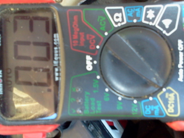

Old Sep 18, 2013 | 02:32 PM
40vern's Avatar
Joined: Sep 2012
Posts: 77
started having problems again
battery draining over night
the picture is of the meter connected to the negative battery cable and the negative terminal
i was wondering if the reading is good or bad?
thanks again

voltage across, current through... all you are showing there is some current drain, which may or may not be an acceptable amount... I can't see the scale that the meter is on.
typically there will always be some kind of current drain, so that reading may never be zero... in my rig, there is a digital clock that's lit up all night, for instance.
we know that if you disconnect the truck battery, it resets the ecu... so I also wonder how much, if any, current drain is required to maintain the ecu... on your pc or laptop, there is a small battery that keeps the voltage up, but I don't think that you'll see that type of battery on the ecu in your truck... so I wonder if it's not using a small amount of current to maintain it's state?
at any rate, the battery could be failing, if it can't support a very small current drain... measuring parasitic current like you are doing there is helpful for troubleshooting, but it's not how you test whether or not the battery is good.
thanks again
If the meter is set up correctly (usually the 10A scale requires plugging the leads into different jacks), then you're showing .003 amps or 3ma. Which will run a 110amp-hour battery down in about ... 3 years. (Don't to get too excited; self-discharge rate of a lead-acid battery is faster than that.) Point is, if your meter is set up correctly that draw will not discharge a good battery in any reasonable length of time. 3ma is about what the clock and radio together draw.
You could, now, switch to a ma scale to get a more accurate reading (your .003 is probably +/- about .020). But even if it's really 45ma that's not draining your battery.
I'm guessing a bad battery. Make sure it's charged, then disconnect it and leave it overnight. Hook it up in the morning and try to start it (better yet, hook it up and measure the voltage while someone is trying to start it).
