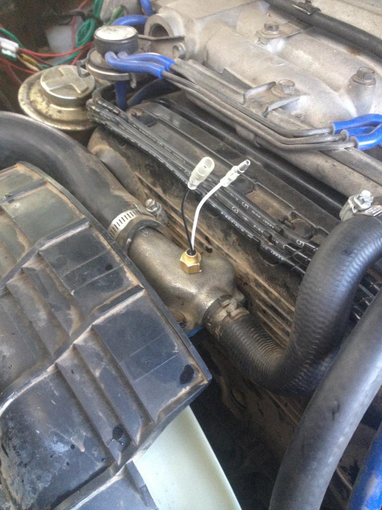

there's a little wire on the back of the sensor that goes bad. when I fire my truck up in the morning the gauge goes to half. then drops down to cold, then shoots right back up to half. I installed an aftermarket electric gauge and tied it into my ignition for the gauge part and headlight switch for the lighting. I'll post a few pictures / videos.
sensor tapped into upper radiator casting neck.
