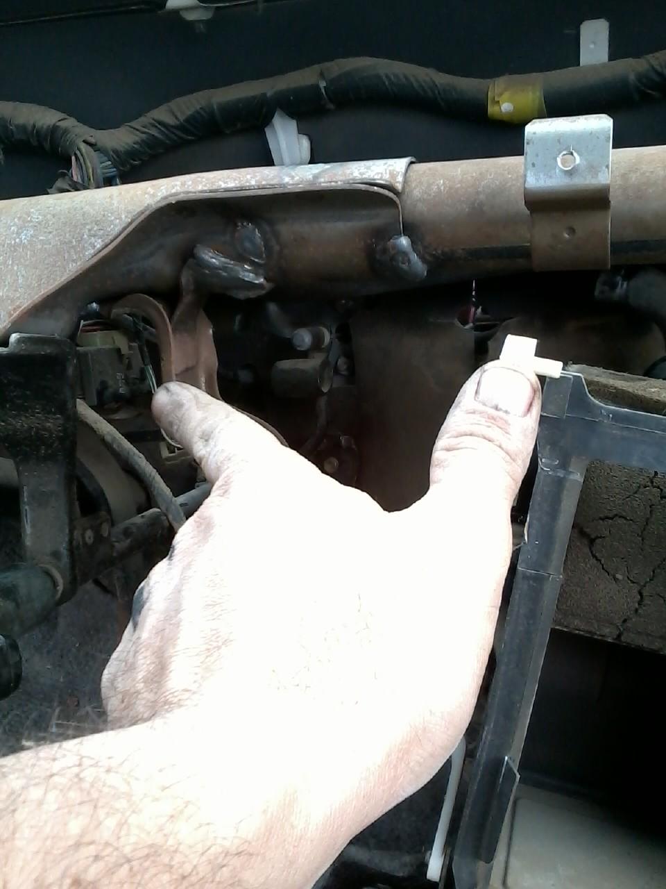

Unhook the 4 cables attached to the heater controls.

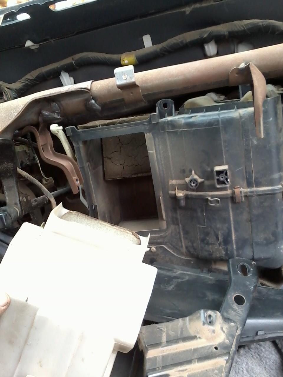

Here you can see I removed the White plastic cover and the side arms that support the dash and where your stereo will mount to.

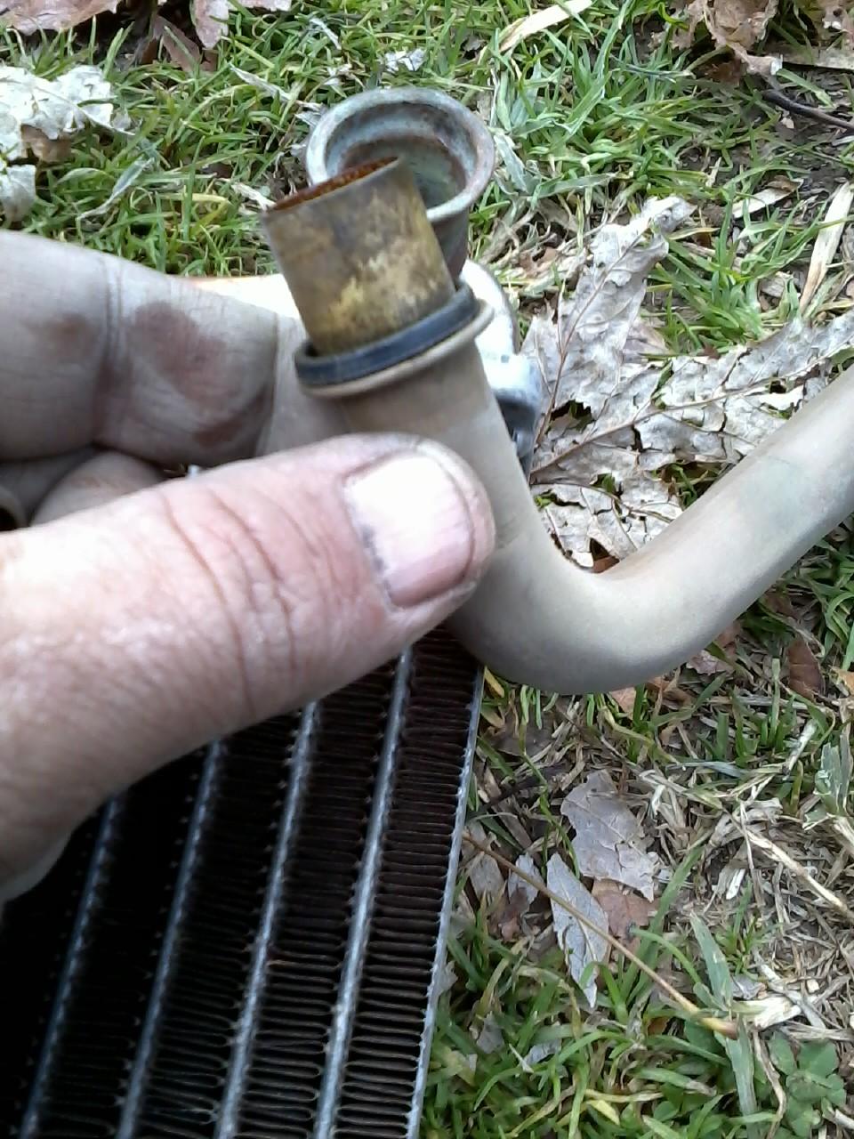

Seperate the pipes from the core. My replacement core didnt come with new seals or the c clips. Be gentle with these as you will need to reuse them. When you stick the old pipes into the new core (you use your old pipes) do NOT try to squeeze them with pliers to try and close the gap. The edge will bend and then you have to straighten it out. I found it easier to have someone to push the two pieces together while I put on the clip.

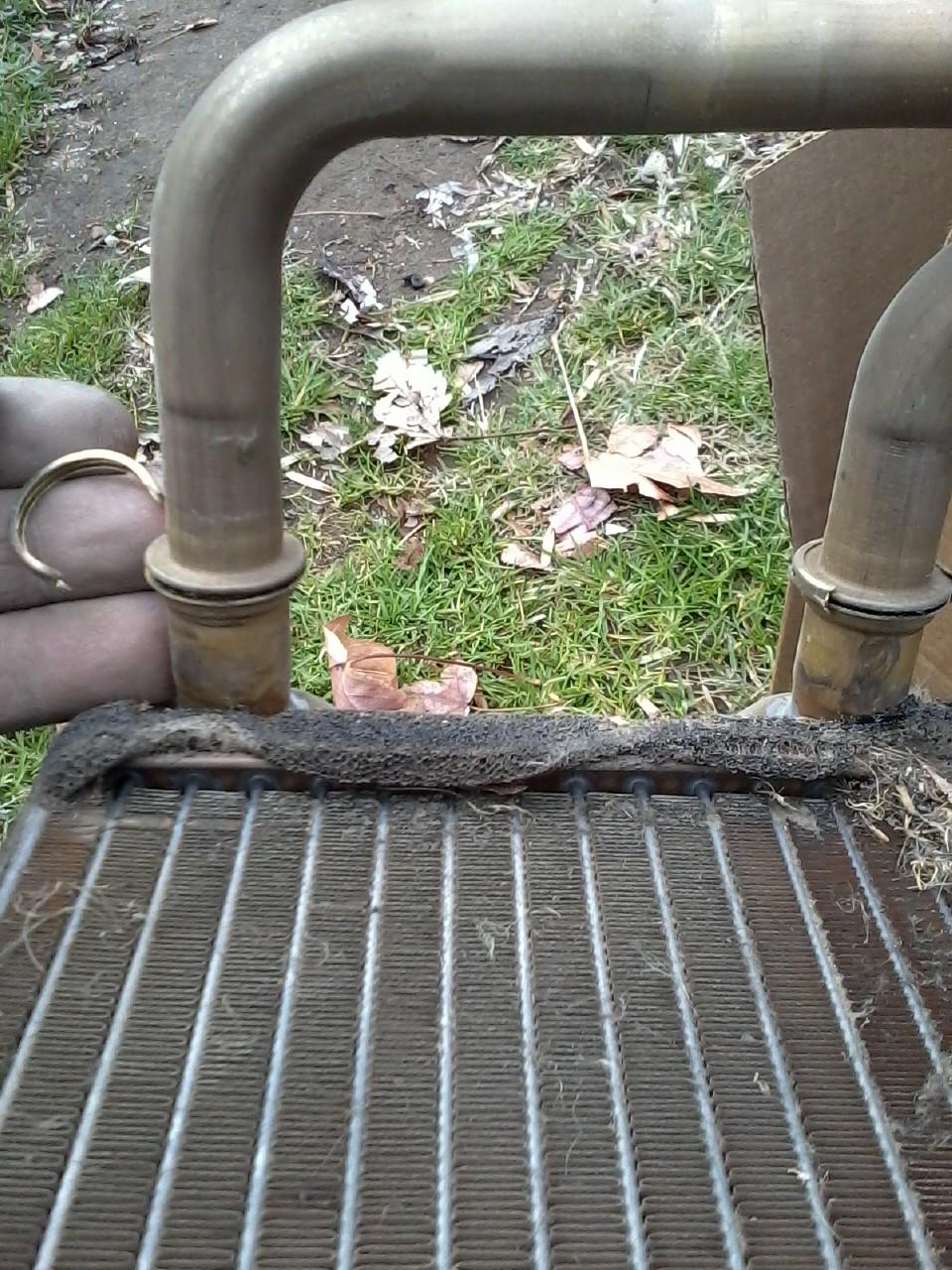

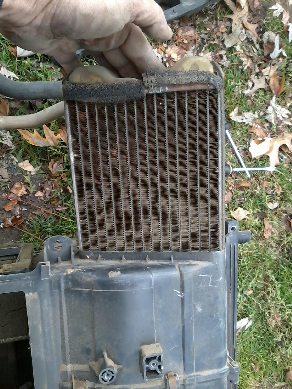

Here is the problem with this core. Steve wanted a new one in it. The old one was actually in great shape, so I will clean the outside and keep it for a spare. I am a cheapscape and can have a core out in 45 minutes, just because I have done this several times.
The first time I changed heater controls, it took me 3 hours. This is not an easy job for your first time but will add this post to my 88 build to try and make it easier for someone who might have to do this. I have some videos of other steps.

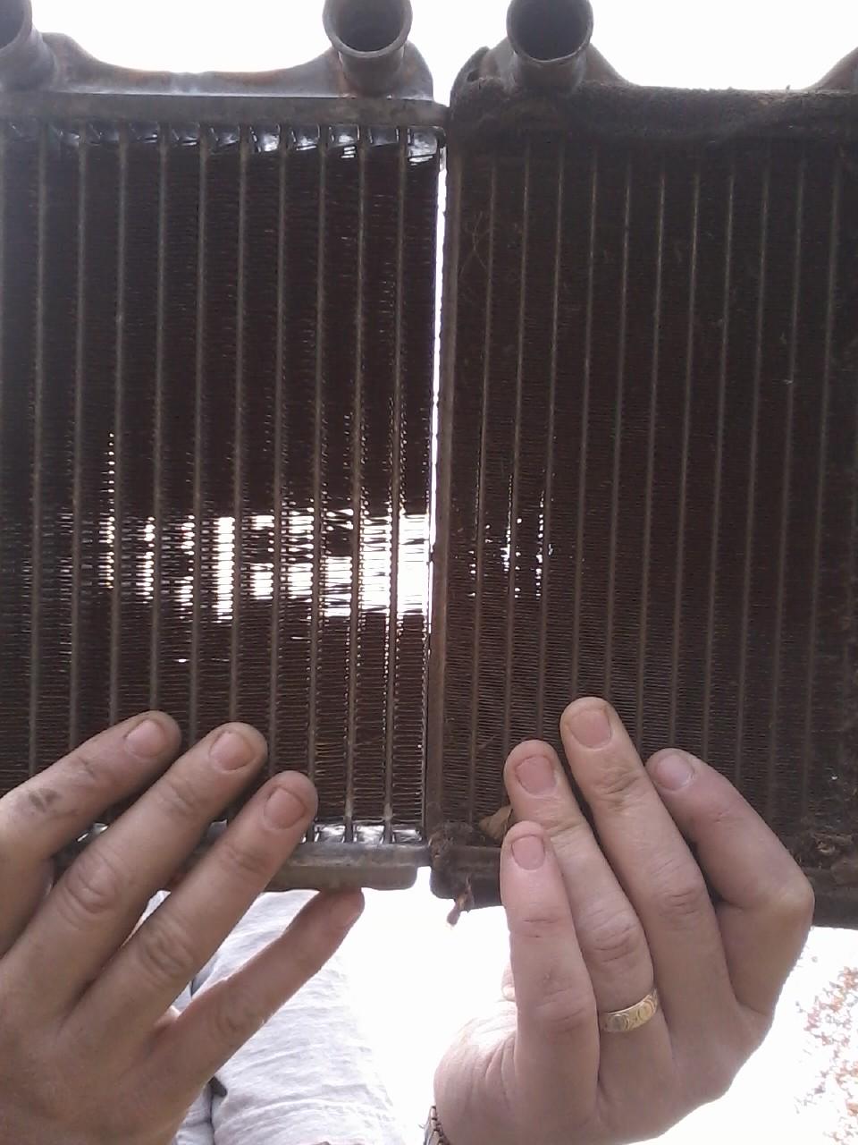

New one on left and clogged one on the right. First time I ever ran into a core like this.
