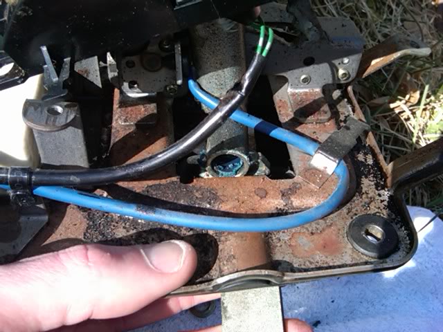

Got it out!!!!!!!

Not sure if I should add some grease around the new bushings to help them out, last longer? It's a tight fit. Or silicone spray?
Old 03-24-2013, 03:16 PM
hockey88fan's Avatar
Join Date: Mar 2013
Location: Leesport, PA
Posts: 139
Received 0 Likes on 0 Posts
Well I just ended up putting it back together, no grease. Im thinking maybe I should have, seems like those bushings will be chewed up in no time. The shifter is tight as new now, real nice.
