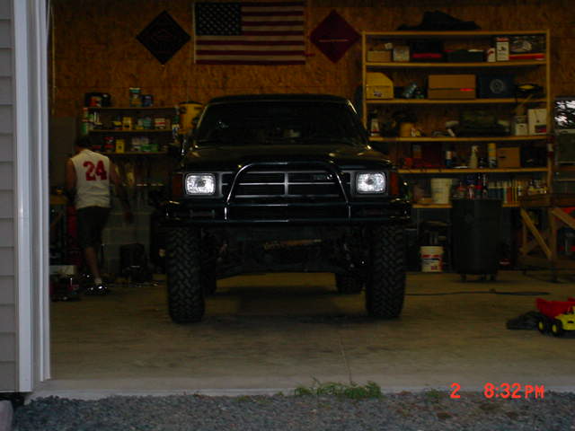

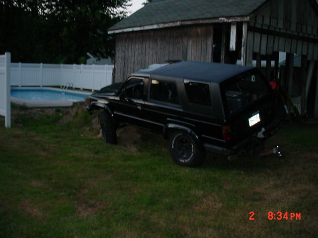

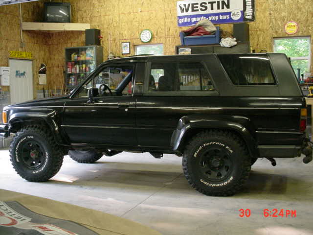

Here are a few pics of mine before and after.
Attached Thumbnails Anyone running 63's and IFS?-mvc-006s.jpg   Anyone running 63's and IFS?-mvc-014s.jpg   Anyone running 63's and IFS?-mvc-016s.jpg

What year 63's did you use Extreme? looks like you didnt get much out of them, still looks like its sagging

That first picture is the before pic. I was completely stock there with the 33x10.5 BFG's. A better after pic is in the thread that I attached. Yotatech would not allow me to repost the same picture twice so I had to attach the old thread as well. I also do not remember what year spring pack I used.
