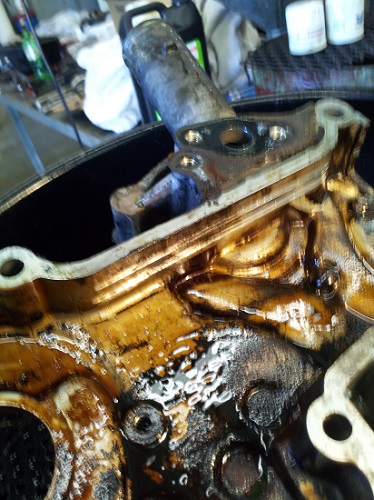

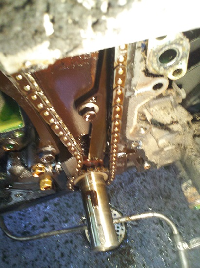

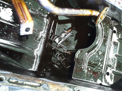

Well just as a conclusion: I got the job done. It took about 9.5hrs and I did have to move some of the suspension to get the oil pan off. Check out my pics. Drivers side guide was toast. It's amazing how much better it runs now. Thanks again for everybody's help.
