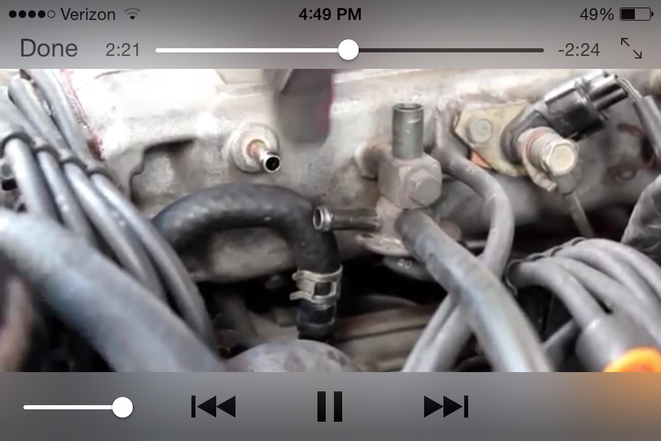

Ok so a little back story, I've had my 95 pu 22re for about 8 years. Up u til a month ago, it hadn't been a daily driver for about 4 years. I had it rebuilt about 28k mi ago, but that's been about 4 years ago also. I got screwed on that because I found out later they did not rebuild it, they just stuck a used motor in there. But that's another story. It leaks and burns oil like crazy now, had since it was 800 mi out of warranty. It's idled terrible for a long time. I can't find no vacuum leaks, I removed and clean the egr valve, it was stuck. I got it freed up still does the same thing. New plugs wires dizzy cap rotary button. It has a bad rattle when you rev it up. I don't have a tach so no idea on the rpms. I thought it was valves, but they were all correct with a feeler guage. Not sure what else it could be. Maybe a spun bearing? It used to run good when driving. Now it seems sluggish until a certain rpm, then it's like it kicks on good. I checked the maf sensor, good. Checked tps, good. All resistance readings were dead on. Cleaned tb out also. Timing was a little off, used a timing light and it's in check now. It idles so rough the engine shakes and my manifold bolts work loose. Any ideas? The cel is on, code is air to fuel ratio lean. But after I drive it and cut it off, it smells like it's running rich? As bad as I hate to, I'm about to the point of taking it to a shop to get fixed.
Last night I was doing a little research. I was watching a video of a rough running truck and noticed this. The spot where that vacuum line is unhooked from that little do hickey on the side of the intake, I don't have that. Mine has a copper plug in it. What is that? Then I got to thinking. When I had it rebuilt, the shop told me my intake was cracked. I got one from a junkyard for them to put on. At the time I wasn't confident enough to do the swap myself. Since then I've done many motor and transmission swaps, rebuilt front ends etc. I also work on small engines on the side. So I'm fairly mechanically inclined. Now I'm tired of fooling it with though😁

What about the timing? Don't forget to jump the connector.
I had a bad head gasket, 5 psi on cylinder 3 it ran very bad. The thing with the screw on it. up's the rpm's when the ac is on or you turn the wheels with power steering.
I don't know about the one coming out of the plenum.

the "one out of the plenum" is for the PCV system.

Here ya go . I took a tone of pics before i started taking hoses off.
Looks to me like hose #6 one mine goes to the vacuum advance on the distributor. That would totally mess up your timing. ( I think)

6 in your photo goes to the power steering switch just behind # 7
there is no vacuum advance in the RE distributor.
but you are probably correct for the OP vid, that open port is for #6.

oh, and i read the OP post wrong. the photo isn't the OP's plenum, instead the OP wants to know what the doohickey is, which you answered.

You are right. I had to take a look at a different angle. All this time I thought that was on the distributor. I have been doing so much lately, I just got confused.
