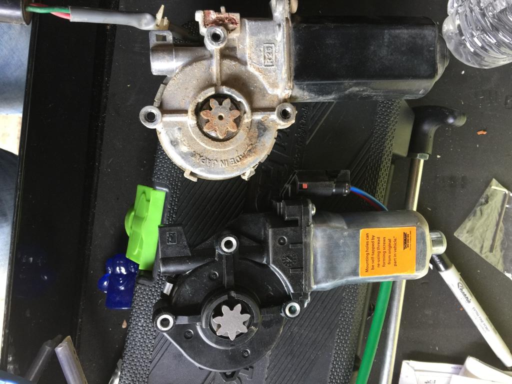

Got a new motor for it from autozone for 55
It's a driver side re manufactured motor runs super fast. now I will look for a new regulator with wiring still intact and a new harness for it and probably a new window eventually the bottom bracket on the window is really rusted I would like to have the rear defrost.
this summer I want to take the top off and let it really air out I think there is a lot of moisture stuck in the cab because the sun came out for a bit yesterday and all of the windows were completely fogged up
Toyota no longer makes the wiring harness otherwise I would buy it new just for dependability
The junk yards are pretty slim pickings for 1st gen runners and pickups there are plenty of 3.0 2nd gens up here but craigslist is pretty much the best bet looking for parts up here so many yota guys and gals out side of Portland the rest of oregon is covered in real "northwesterners" so chances are trying to get a good condition regulator and harness is looking expensive. I might be able to salvage the wiring for the rest of it but I'd need some new plugs for the loose wires and will definitely need a new regulator.
