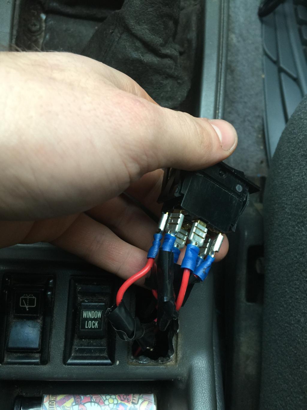

I pulled out the switch it's a 15 amp 5 pin. If I'm correct its double pull double throw. I'm going to pick up the same switch today after work.

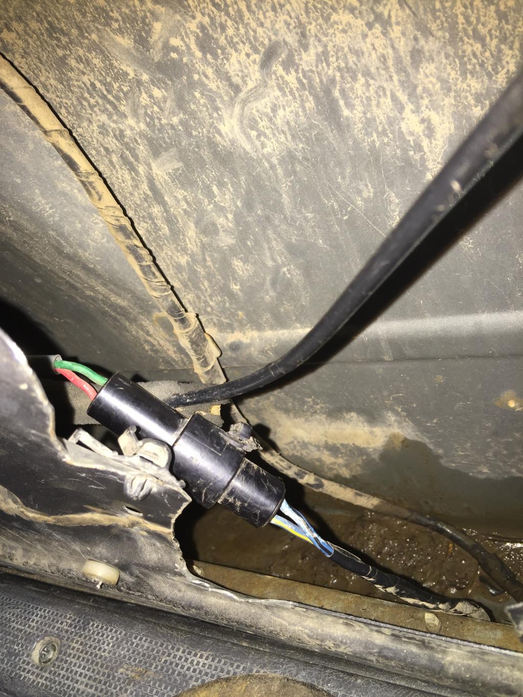

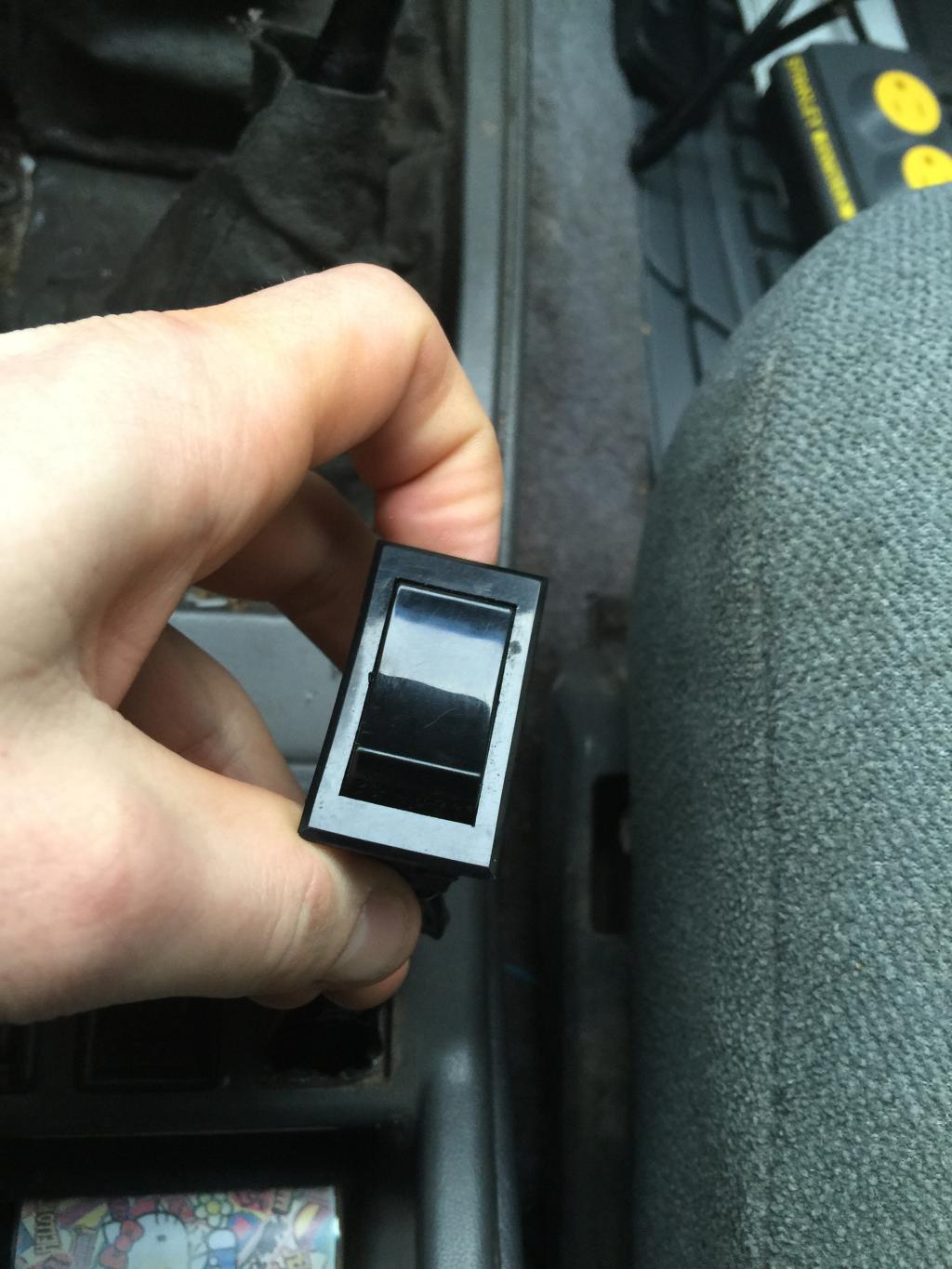

Ok here's some pics of the switch the motor and the window assembly turns out he switch is a 6 pin switch

So new switch didn't fix it good thing they do returns

Someone seriously butchered that wiring. The white wire with black stripe is ground for something. Unfortunately I do not have the time to dig into my tailgate to find out.
When you took out the motor, how many pins did it have? Which pins had wires matching schematic?

I haven't taken the motor out I just connected the 2 pin plug to the battery with little jumper cables. My motor had been sounding rough and it took forever to go up I think my best bet to go back to factory would be to find a new assembly that hasn't been hacked up I didn't want to take out the motor because with out it the glass will not stay up
