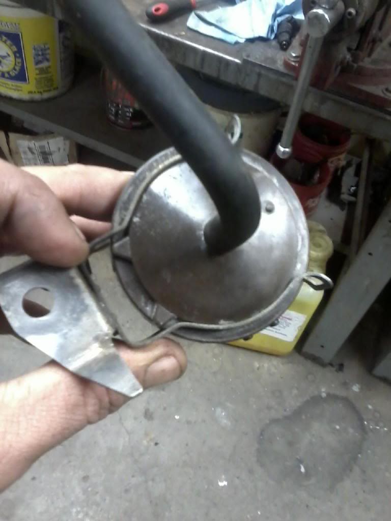

After it is apart, I use a drill bit, screw driver, nail, clothes hanger to get all of the carbon out. It is rock solid in places. You can put vacuum on the hose and see and hear the plunger moving and operating inside the EGR, the goldish part. I just use the vacuum of my lungs to test and hear the EGR operating for testing purposes.

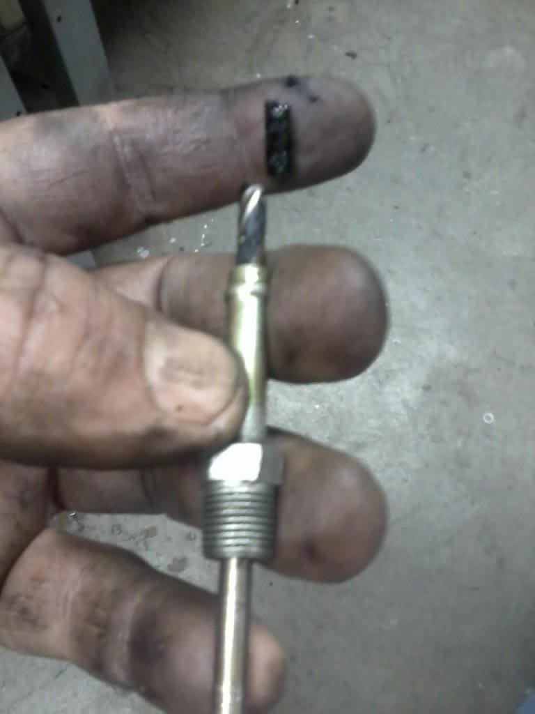

Here is one of the metal pipes that was clogged. The carbon gets hard as a rock. I use a drill bit with my fingers to help break it loose. The carbon on my finger is only half what came out of the pipe.

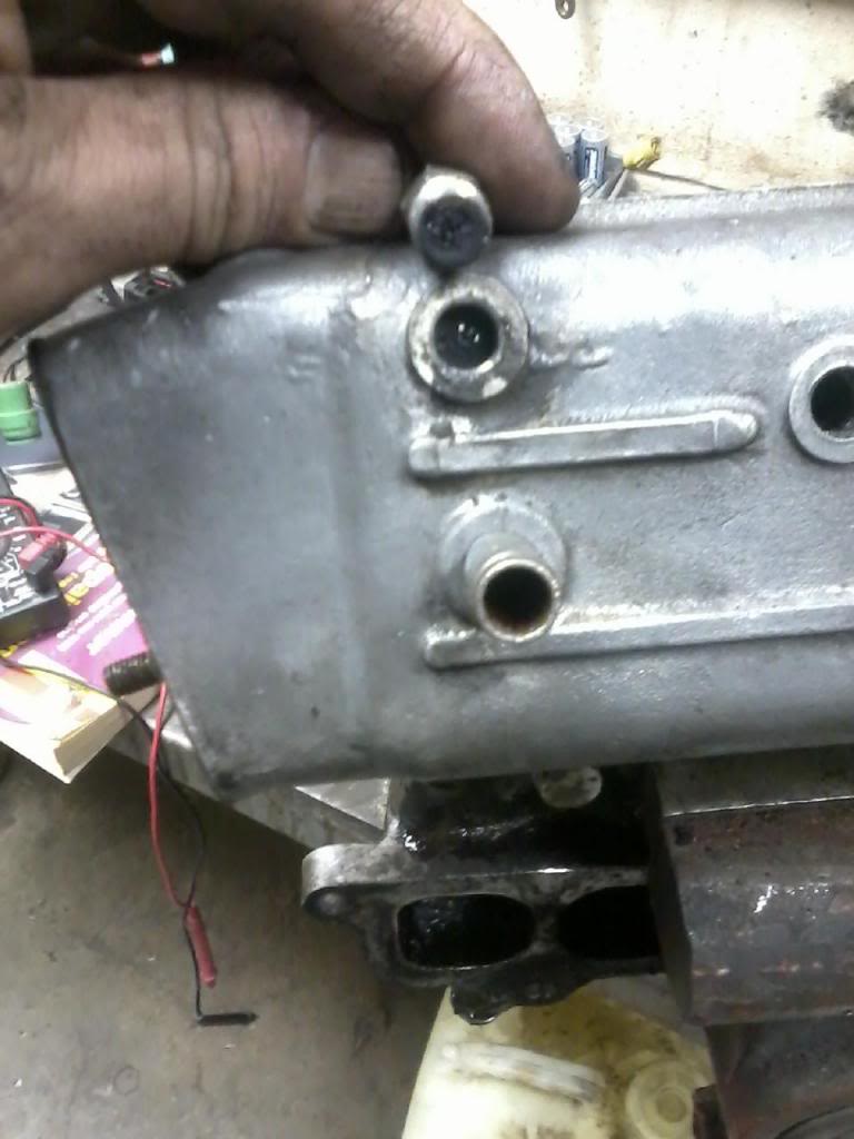

This is the same port that was clogged. The rest were clogged just as well. This is normal as to what you are going to find on a 150k mile or more trucks.

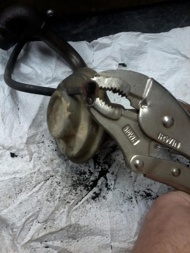

I worked on the EGR. Here is another picture that may look like the wrong way to do this, but the screw will strip if you use a screwdriver. Get a good firm grip, but not so hard to distort the screw.

With the screw out, get another bite on the the pipe to get it out of the EGR. Leave the carbon in the pipe at this time as it will help keep the pipe round. The carbon is hard as concrete. Slowly work back and forth to get the pipe spinning inside the EGR tube and to start breaking it free. Could take up to 10 minutes but just be patient.

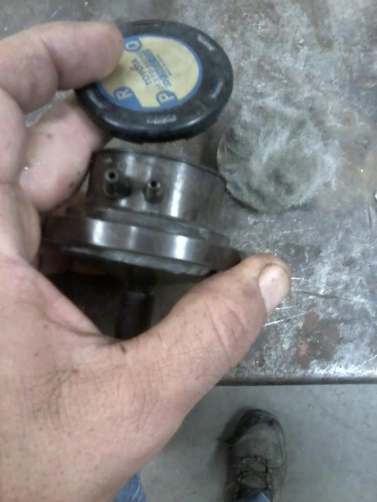

I cleaned the valve to the EGR. It is marked on the sides with "Q","R","S" on the brown part as well for correct reposition. The cotton like material is easy to clean, just need to be careful with it. I also got the metal lines that connect to it cleared. One was clogged. The black top just comes straight up to remove. Will need to check the plastic lines are clear as well on it.
