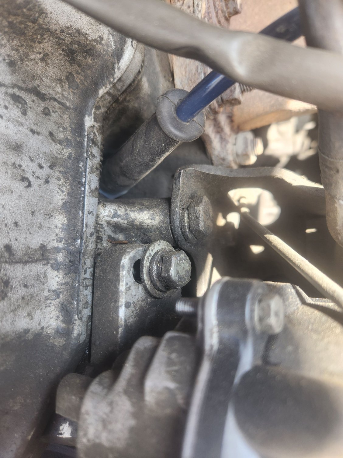

The adjusting bolt that locks down the distributer, is it fairly centered in the slot, or is it off to one side?
Is the fuel filter just propped up, or is it bolted to something? It's supposed to be bolted to the block just above the starter. Some relocate it to make it more accessible, but since it's so rarely replaced i think it's better left alone. I don’t think bending a 36 year old pressure hose that way is good.
Your accelerator cable is under hospice care.
The ground wire bolted to the intake/plenum is wrong, too. It went to the center-rear bolt on the plenum.
I'd focus on getting things hooked up correctly. It's going to be hard to troubleshoot an engine with SO many things altered and removed.
Go to epc-data.com and you can get pictures of parts sorta in their proper place/orientation.
edit: I just noticed the vacuum rail the runs along the right side of the valve cover is missing. Did the previous owner give you all the stuff they removed? Can you get?
here's the distributor bolt you asked for. It's cocked off mostly to the side. As for the EGR modulator no, never got one with the truck. I'll look at getting one and fixing the ground cable. Same goes for the rest of the stuff you mentioned vacuum wise. I got no extra parts with the truck, looks like someone had a field day with ripping out random lines for no reason and I'm doing damage control, problem is, I have no reference to what I'm missing. This is a good start in regards to that problem however. Fuel filter is propped up, it was originally half bolted on the intake manifold (wtf), but I'm going to find a new spot to put it. I am aware my throttle cable is bedridden with cancer, I'll put it out of its misery soon lol. Any idea why the previous owner would rip all this stuff out? Maybe a half done EGR delete? If so would it be easier to just complete the process?

Ideally, the distributer should sit about in the center of the adjusting slot once timing is set. Maybe the owner didn’t set timing right. Is the TPS centered, or is it maxed out to one side, too?
