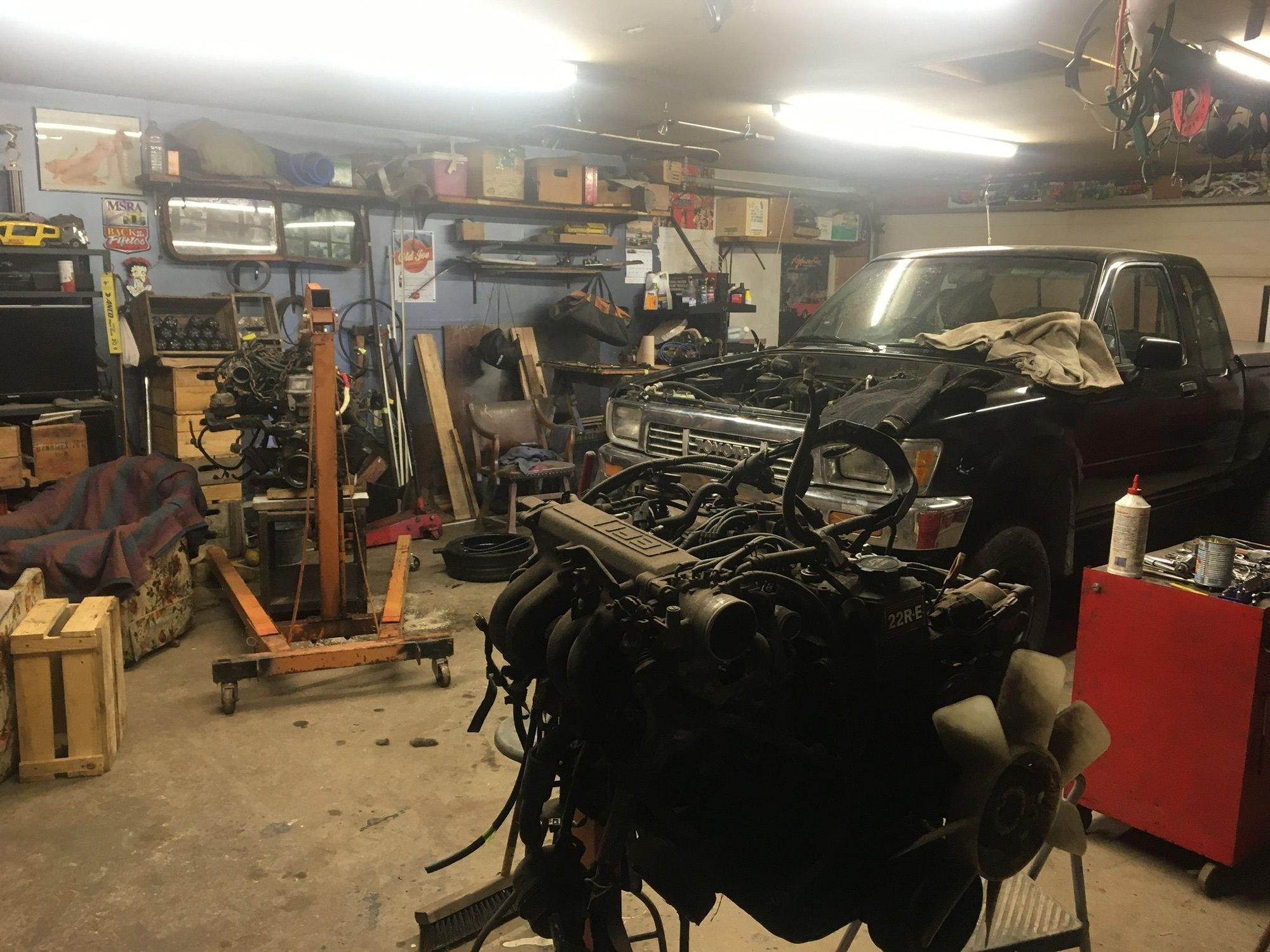

My son put a Evergreen head in his truck…the cam didnt last a week..
I had a rebuilt long block ,,Universal Industries,,,head gasket went a 10K, timing chain guides went at 40K throwing the timing chain and destroying valves and possibly scoring pistons so im in the process of installing a used engine i bought dirt cheap as donor for cheap,,,mechanically sollid, engine purred,,Mechanically excellent and owner drove it to deliver,,even comment it sound better than my engine and he was correct
My point is know what parts brands are going into your rebuilt engine and heads. I will pay a premium and have the work done locally by reputable shop if such service is required.
This is my first time swapping a modern engine,,my only experience swinging engines is older carbureted NO ECU engines
This has become a project,,i have a spare CAMRY to get me to my Jay Oh Bee
Freddy already searching for the 10 mm socket
