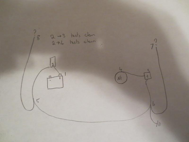

I left the battery hooked up yesterday when i thought it was just a charging issue, as it is a short it drained my battery. My multimeter agrees with the reading advance auto gave me when i took it it to get it tested(pre-buying my own multi).
So i pulled wires till i found the draw, and i won my money, its the heavy gauge wire that goes to the alt.
Rough diagram of what i am working with.
As noted my continuity tests say that the alt to fuse box is good. But yet that is where the short must be. Unless... its grounding out through the alt. Lemme go unhook the alt and try again.BRB

Doggone it! I was right. I unhooked the heavy gauge wire from the alt and my battery voltage jumped from 2 -> 9.5.
I am shorting the battery through the alternator..... Does this mean i have a bad alternator or what?

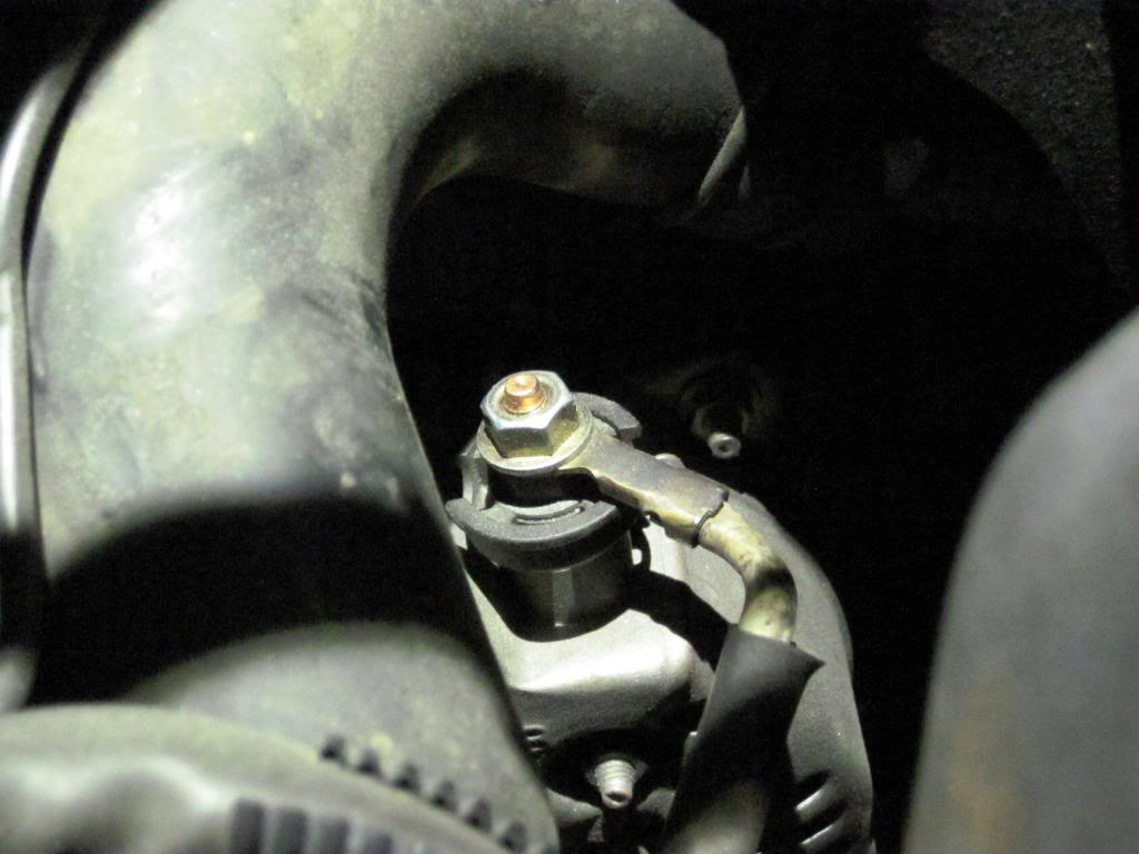

It is possible for rectifiers in alternator to go bad and cause drain even when nothing is on.
Try this:
Unscrew nut and disconnect thick white wire from "B" terminal of the alternator.
Measure resistance from the copper bolt to ground (i.e., ohm setting, red test probe on copper screw, black test probe on chassis ground/alternator body). You should get a very high resistance. I got 0.357 meg-ohm using my nice Fluke [0.395 meg-ohm with my HF special ] If you get significantly lower than that, you might have bad diodes or stator winding sorting to ground.

YES, it is possible for rectifiers in alternator to go bad and cause drain even when nothing is on.
Try this:

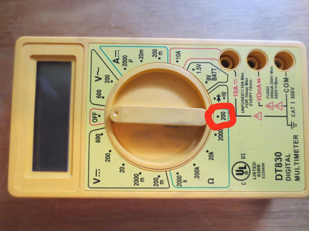

Okay. Not sure which setting is mega ohms but i set it on 2000 ohms and it tested 1-2. So i dropped to 200 ohms and it tested 2.1.
How does that relate to the measurement you have?
Note: this measurement did not drastically differ noticeably whether the measurement was taken between the bolt and the alt body or the bolt and the chassis.

I had another go at testing the shorting theory.
I discovered that the 20k ohms setting yielded a x.xx number similar to rad4runner's measurement but i couldn't get anything to register on that setting.
I do however still get the readings on the lower settings as i detailed above.
I also, just a random thought, tested for continuity between the copper alternator bolt and the chassis, and it beeps loud and clear. So it is clear to me that it is shorted out.
Is there any other thing that could be wrong or do i just go ahead and order an alternator?

Both above shows you have 2 ohms between B terminal (Copper bolt) and ground, meaning shorted alt. Alt body and chassis are electrically connected (ground) so same reading.
Yeah, sounds like bad alt. However, because we are working remotely, and unlike shops that guess and make vehicle owners pay for their wrong guesses, we need to verify.
Please post pic good resolution (fills up whole screen) of your setting (200ohms?) and reading.
And you disconnected alt from battery, of course?
Can't get a reading as i'm not at home. But with the circled setting selected i got 2.1
Yup i am disconnected from the battery. First thing i do when i pop the hood.
