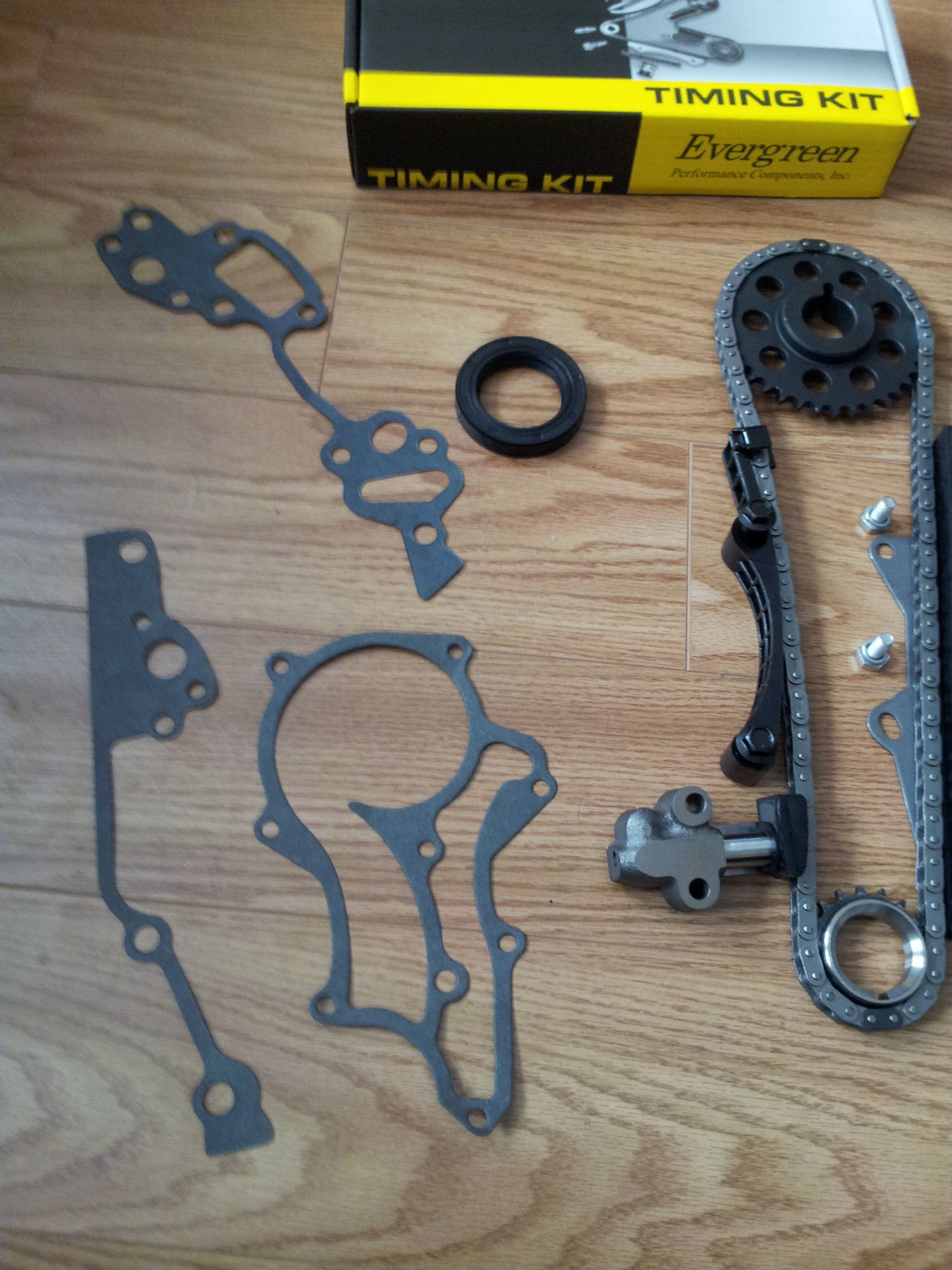

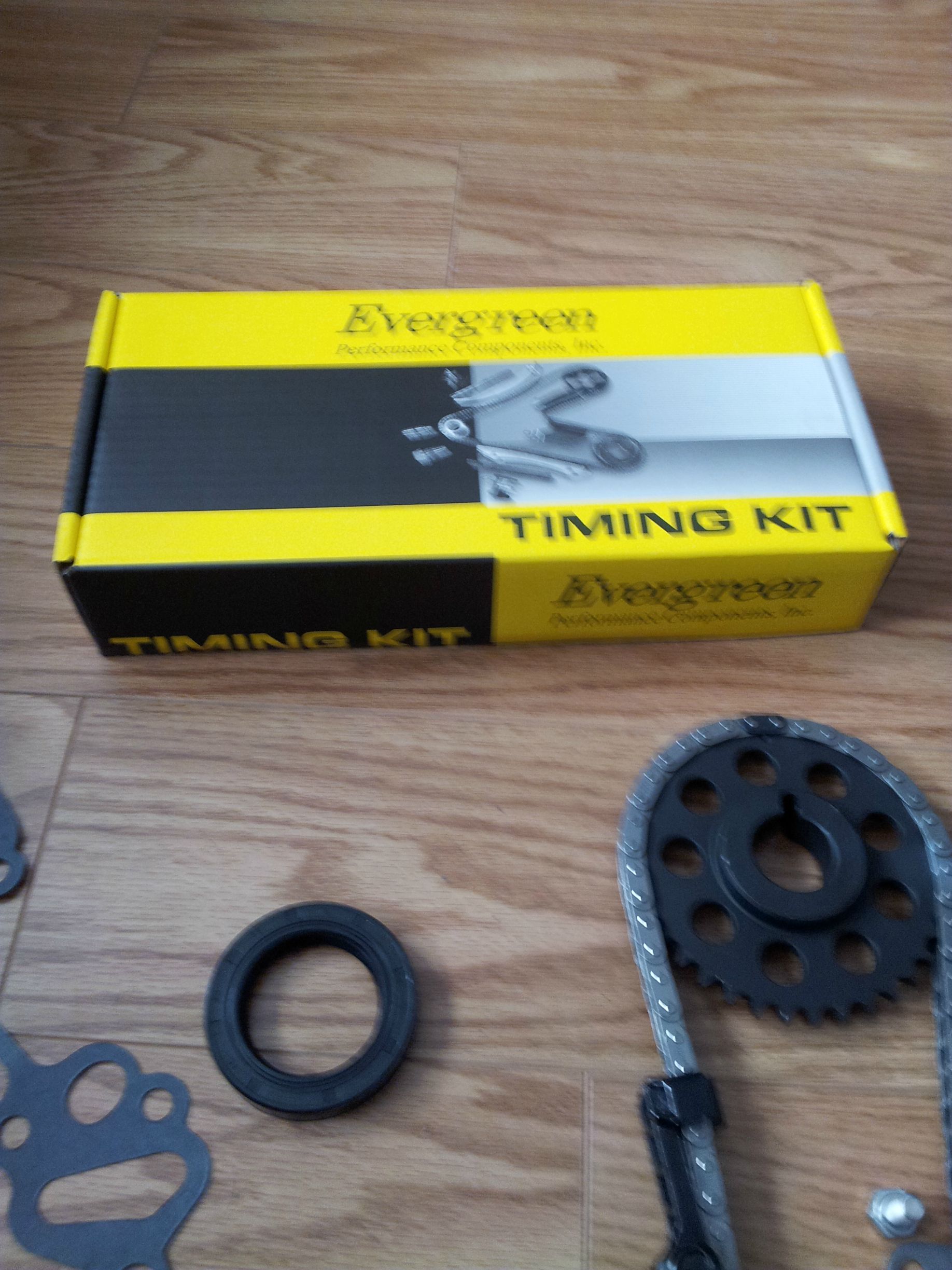

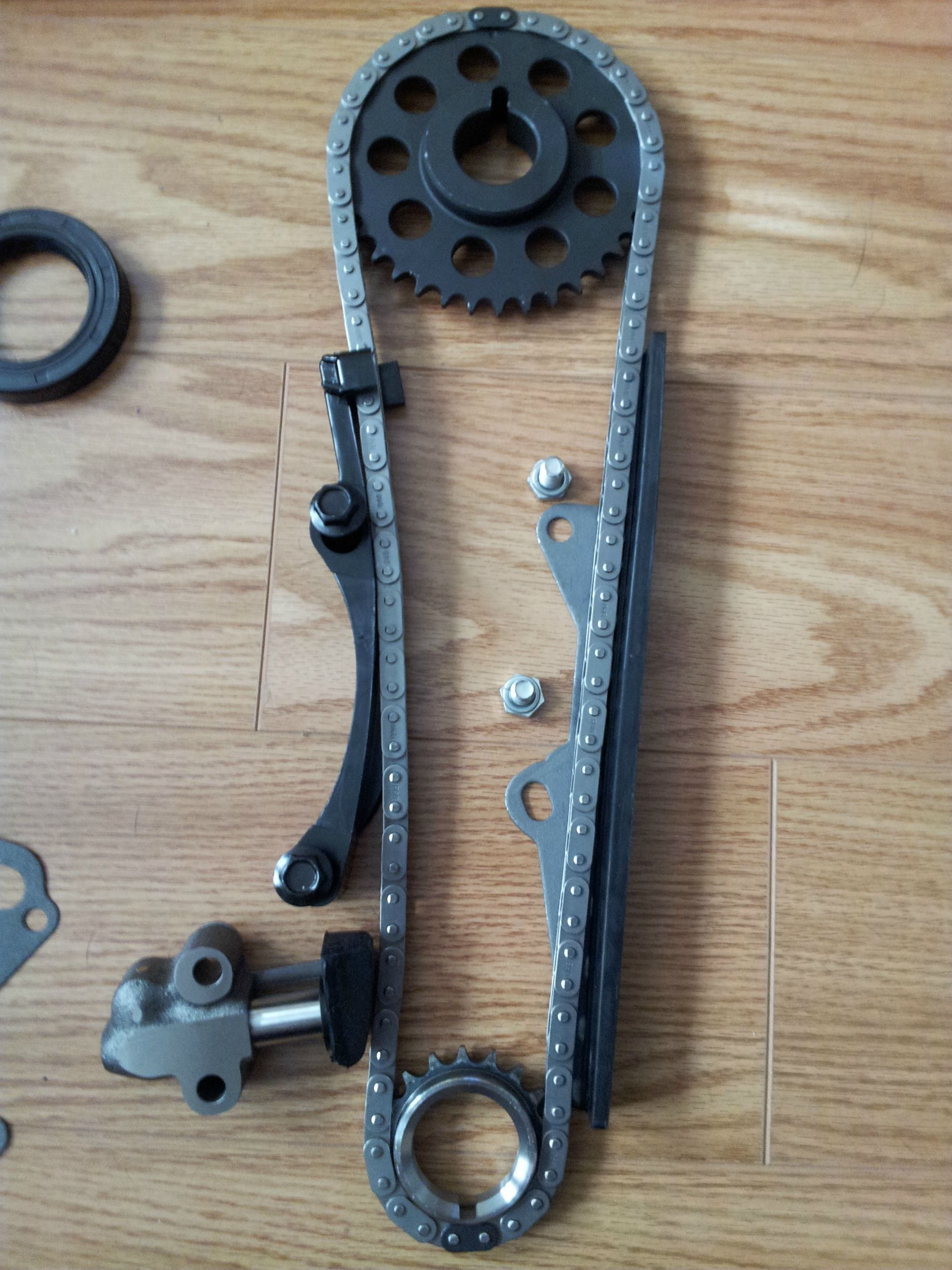

Well after all that i determined the water and oil pump was still good as i replaced them when i did a full rebuild. So i order only the timing chain kit and it arrived today! The kit is made from Evergreen and all the parts look of quality and I'm very pleased with it.
