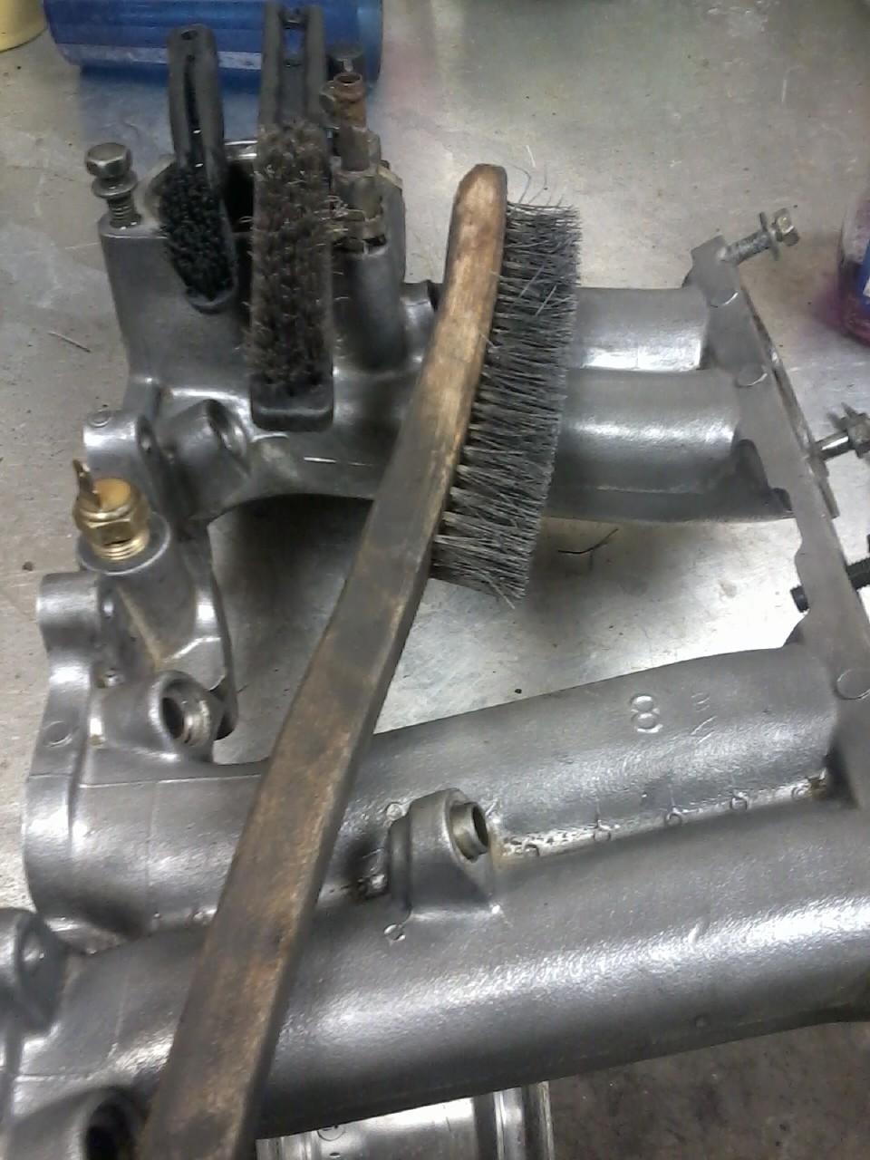

Here is one from Terrys87 85 build, don't worry pretty sure thats a 89+ engine from his brothers truck, it has a good angle.

OK one more question...in that photo you posted from Terry's build, it's the flat area just below and to the right of the brass sender that's standing up straight up - just to the left of the wire brush? One would drill/tap perpendicular to the existing brass sender there?

Yep that is the spot from the earlier photos, just below the sender is a round hump drill the center of this then decide if it's thick enough for threads if it's not thick enough for your taste or there is interference of the flow or senders have them attach a nut/bung on the outside.
