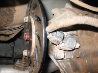

Well, got my all pro transfer case parking brake kit and the rotor hits the sensor for the speedo. Called all pro, dont know who I talked to but told me he had no idea how people fix this and to try front range? Searched all over the place and cant find any info on it.
Do you guys have a fix or a adaptor the might work or am I S.O.L on the speedo.

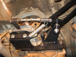

Wow, I did not have this problem at all with mine. I have the trail-gear doubler, the stock forward-shift as the reduction box, then an unknown vintage for the second case. Cable cleared with no problems.
Here's pix of mine installed, not sure if you can see the speedo connection:
We need more info on your setup, something doesn't sound right.

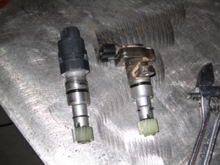

Okay, finally got this thing figured out. In case any body else wants to know.
Got an adapter from marlin crawler. Clears the disc now and barley hits the mounting bolt. Works perfectly now.
Brian
