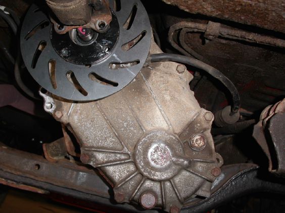

I just got my Parking brake from allpro .
I have a 1991 Toyota Pickup 4x4, I got it a year ago and i am not sure if the transfer case has ever been changed and there is no way to get in contact with other owner. So i thought i would ask the PRO's.
My Problem is the bolt pattern on the brake and the bolt pattern on the transfer case will not line up. All Pro add says Fits 84-95 gear drive 4cyl transfer case equipped pickups and 4Runners. Can someone tell me if this is the original transfer case for this truck or has it been changed. Has anyone ever had this problem with the all pro parking brake before?

Dumb question, but were the chain driven cases have a different bolt pattern? I don't remember right now the years they were used and stuff....It's been a long Friday at work (and it's only 11:15AM)

That's not a G or W series X case, but a R series, not gear driven but chain driven. That should be bolted behind a V6.
You will have to fab you'r own bracket for that application. Here's mine:

^ Sweet I was right (sort of), so was it 4=gear & 6=chain or is it more of a year thing? Damn I can't remember...

Yep, that's correct.
Only the 22R-T uses a gear driven R seies I think.

I see 3 bolts to your T case .... is there more then that ?

It's 4 bolts.

Did you have to move your E brake cable at all ??????
By the way i made the mounting bracket thanks for the tips .

I made a new bracket for the cable due to the 3 link front SAS. It should be okay since mine still is located in about the same spot, just a different bracket.

I may have to mod the bracket for the cable, it is pulling on a 90 degrees now. I am not going to relocate the bracket just going to cut some out and bend it in and weld it back up so it is not pulling on a angle. Thank you again for all the ideas and the pic's it helped me allot.
