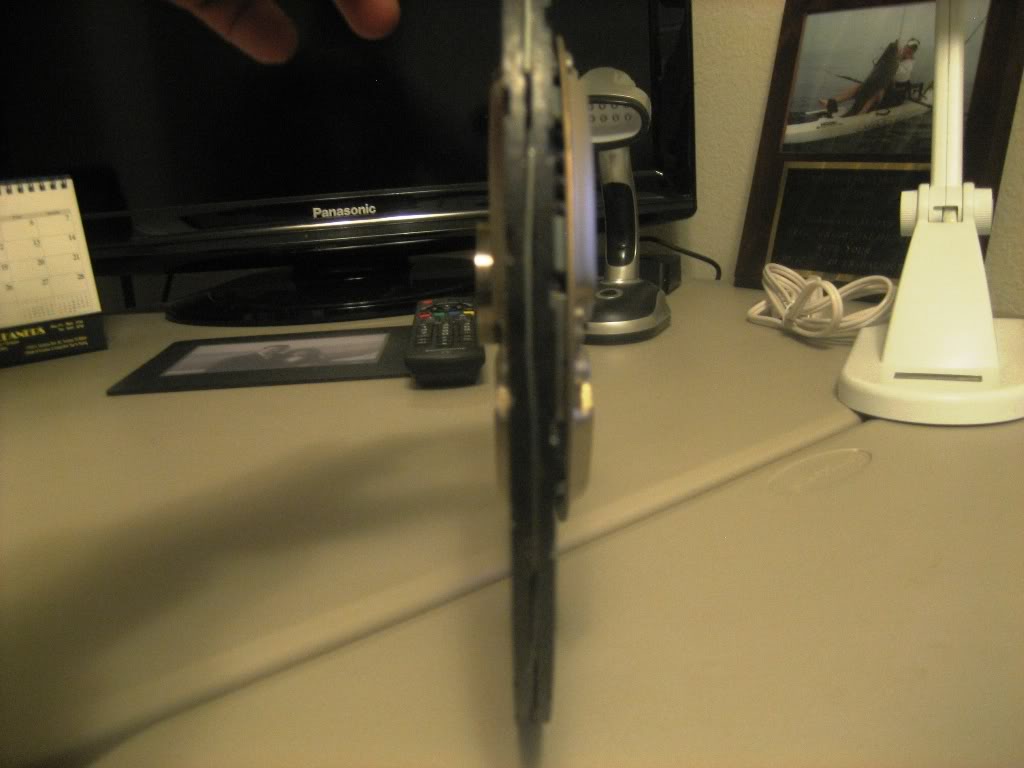

Side view - I'm assuming the flat side is where just the spline (that's what I'm calling it...) is sticking out

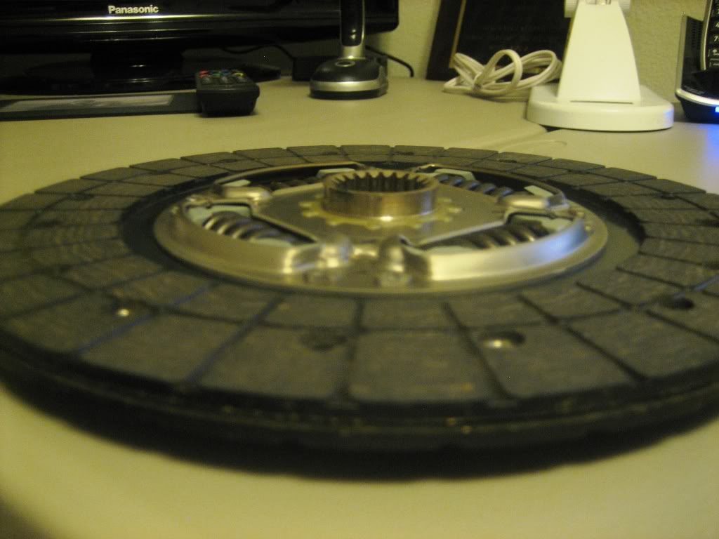

Again...the Spline sticking out and springs more flush, so this is the flat side that goes toward the flywheel, correct?
The bulkier side with springs stick out more but spline covered more, goes toward the transmission side, correct?

Correct. Springs on the transmission side. I know my Marlin Crawler kit (Seco clutch disc I believe) had a paper telling me this.

bmcghie is correct, springs side out...

Bingo, springs out.
My NAPA clutch actually has Flywheel stamped on one side in the metal.
Surprised their not all like that?

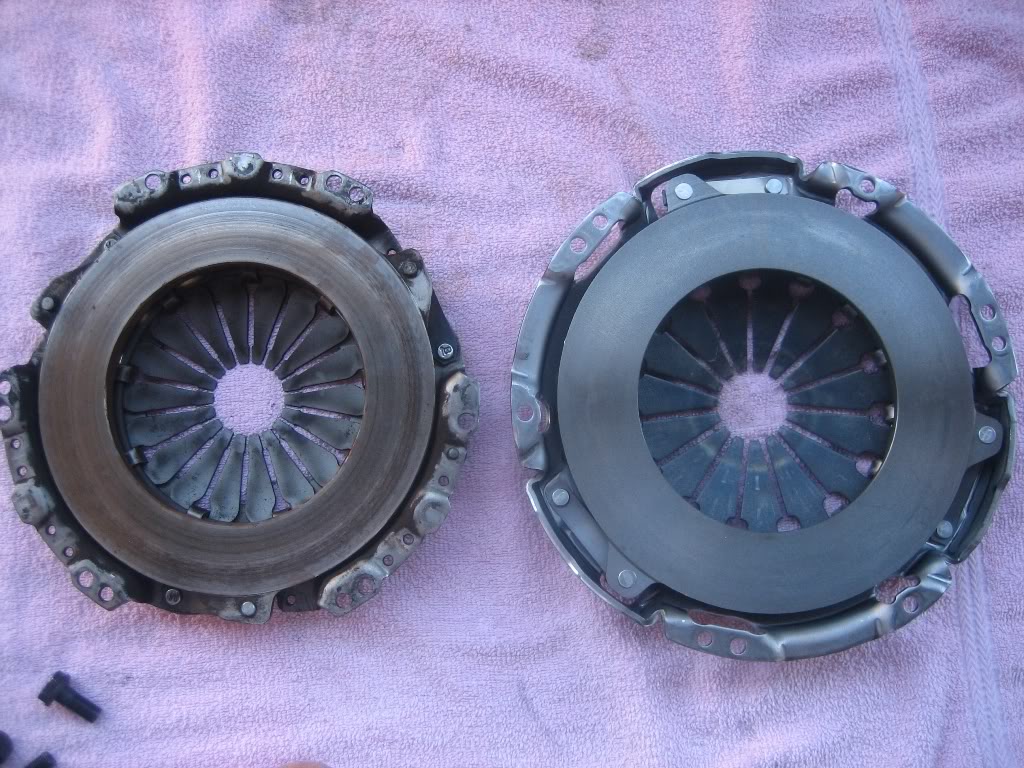

Well, bad news....the clutch kit didn't fit. The plate diameter is too big. Funny, the box says 92-95 4cyl, but doesn't fit my 92.
The flywheel is stock oem (Taiho I think at the emblem I see on it), plus if the flywheel was any bigger it wouldn't work anyhow, so must be the wrong kit.

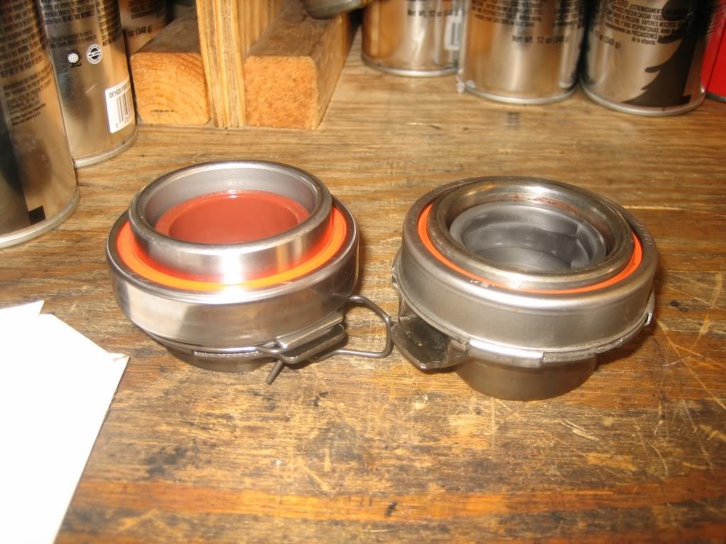

The bearing, I didn't think much of it at the time, but maybe that should have triggered me to do a little research. The old is on the right and new one from the kit on the left.

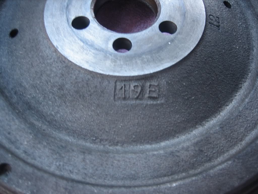

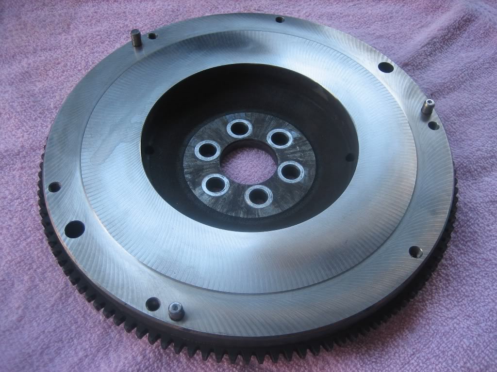

My Flywheel, I thought it was a Taiho logo, but maybe not. Notice the 3 triangles on the upper left? those are the same markings on my main crank caps to show which way points toward the front. What do those triangles mean on the flywheel? that side points up??

Resurfaced side...

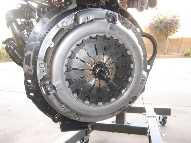

Comparison of the old on left, to the new on the left...notice the diameter difference
The new cover on top of the flywheel. I have one pin lined up and in the hole at the top, but you can see how much larger it is than the flywheel while trying to line up the rest of the holes.
That spells Toyota, in Japanese(Katakana script). Proof that it's OEM.
I have seen that marking before. I feel like I should know what it means...but it's not coming to me at the moment.
Definitely not used as an indicator of install direction. That I've ever seen anyways.

That release bearing and pressure plate look identical to the ones for my V6... just sayin'. Busy worker bees in the shipping department may have grabbed the wrong box for ya.

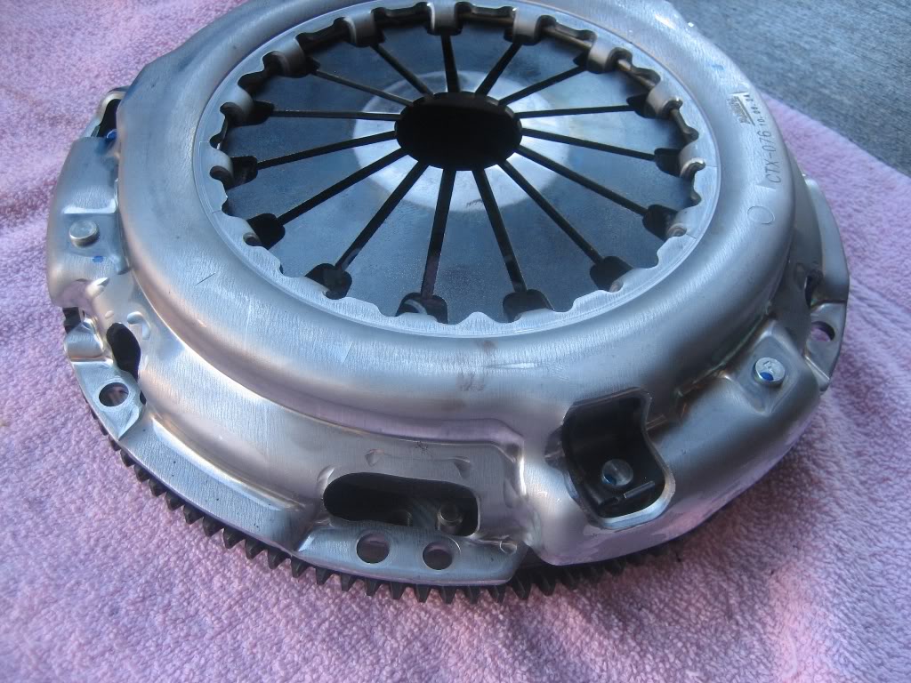

Some pictures
The new kit
The CKT-022 came with a Koyo throwout bearing, the same as my old one and looked identical to it. Luckily the pilot bearing was the same Nachi one so I didn't need to go through that hassle of removing that part again (used the wet newspaper trick from this board).
Much better this time!

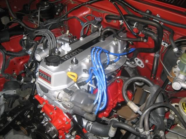

Back in it's home!!!! Relieved to have gotten it in and excited to keep moving forward.

From the link to the AISIN catalog above.
CKT-022 Clutch Kit 224.mm Disc, From 08/1988, To 08/1992 2.4L, 4 Cyl, 2366cc, (EngDesg) 22RE
CKT-049 Clutch Kit 239.mm Disc 2.4L, 4 Cyl, 2366cc, 4WD, (EngDesg) 22RE
