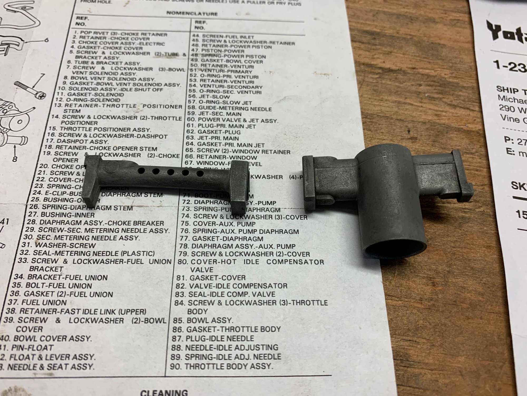

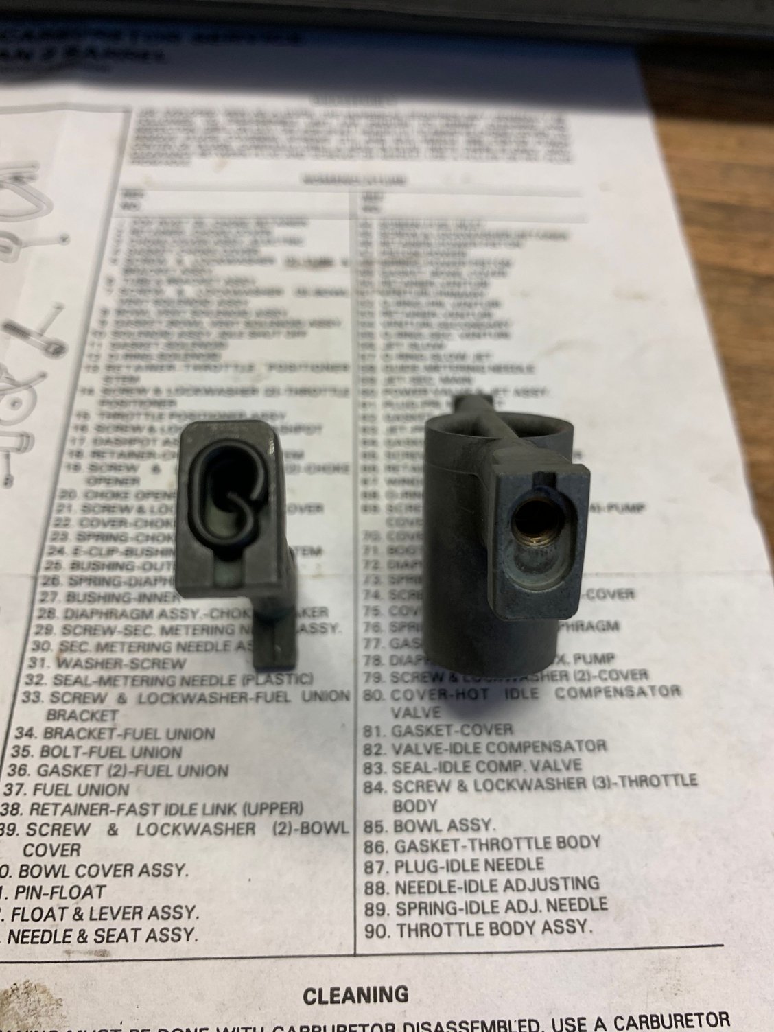

Explode view provided with the kit
Originally Posted by old87yota
That is weird. What carburetor rebuild kit did you buy?
Those "O" ring seals should have came as part of the kit and should still be available to put them in the kit.
I don't remember what size they are, but they need to be rated for gasoline use.
I think one of them is molded into an oval shape and the other is just the standard "O" shape from the kits I have bought.
I will have to check to see if I have some spares.
I bought the Toyota 22R Carb Repair Kit (15827A) from yotashop.com. From the diagram it looks like they both are oval shaped. The one that came out of it is somewhat tall and wide (and obviously torn, that's how it was when it was removed, other side completely missing). I was afraid to slap regular o-rings in it due to restriction of flow threw those ports. Thank you for checking!

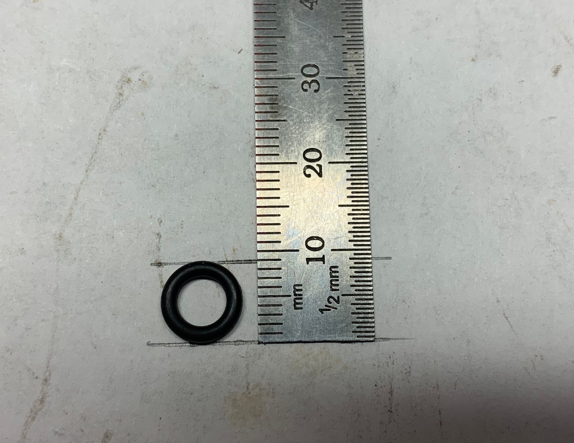

Right, sorry. It appears to be about 9mm O.D. and 5mm I.D. Hope this helps. I'll post later once it's back on the truck!
9mm O.D. 5mm I.D. Used to replace pri/sec venturi o-ring.
