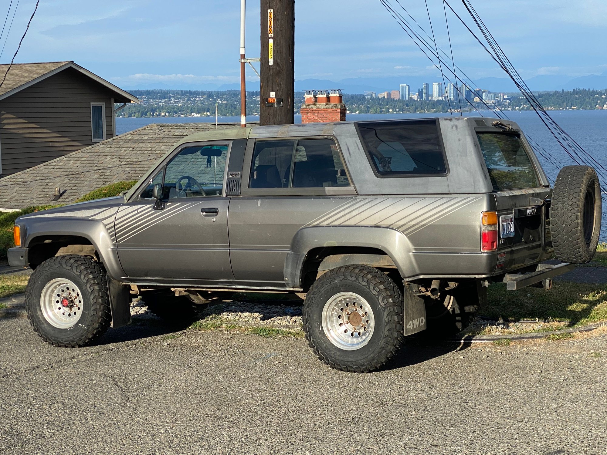

I’m looking for some advice on painting the canopy on my ‘88 runner(attached pic).
I do eventually plan on painting the actual truck OD green as it will be used mainly as a hunting rig. My question is should I just go ahead and paint the canopy od green now or just go with black or dark grey?
just looking for some opinions on this cause I can’t picture how it’d look. Thanks in advance!

Your body paint is still showing a decent gloss coat, I think it'd be a shame to paint that.
Blacking the canopy I can agree with.

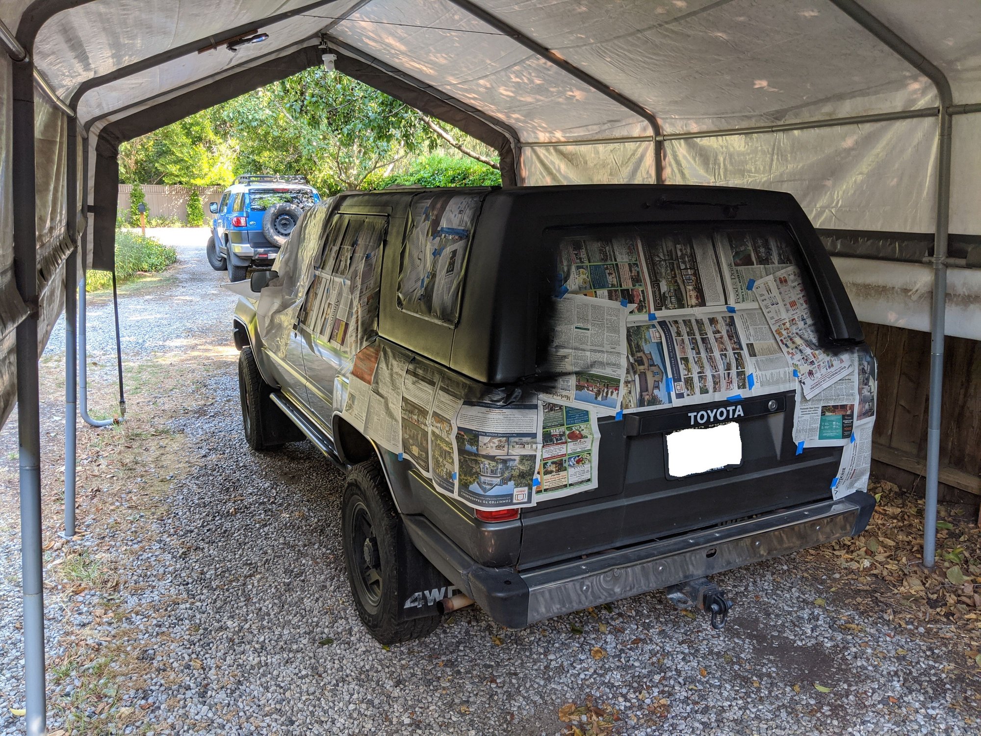

2) Mask off the windows, rear wiper, rear washer nozzle, rear window, front cab. Took me an hour or so with blue tape and newspaper. Be generous with masking as no one likes overspray.
3) Sprayed two coats of the bedliner paint. I did it outside on a no-wind day under a carport, and wore a simple respirator filter. I used 2-1/2 cans of Rust-Oleum 248914 Truck Bed Coating Spray, 15 oz, Black.
4) Remove all the masking end enjoy the new color!

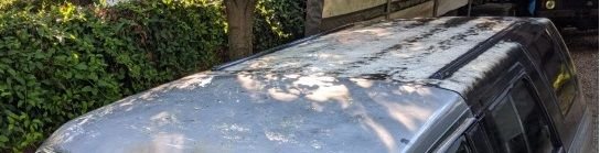

Before. Note almost all gel coat is gone.
masking and paint booth

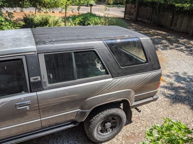

Final result. I could have done a better job in the middle vertical section between coats.
