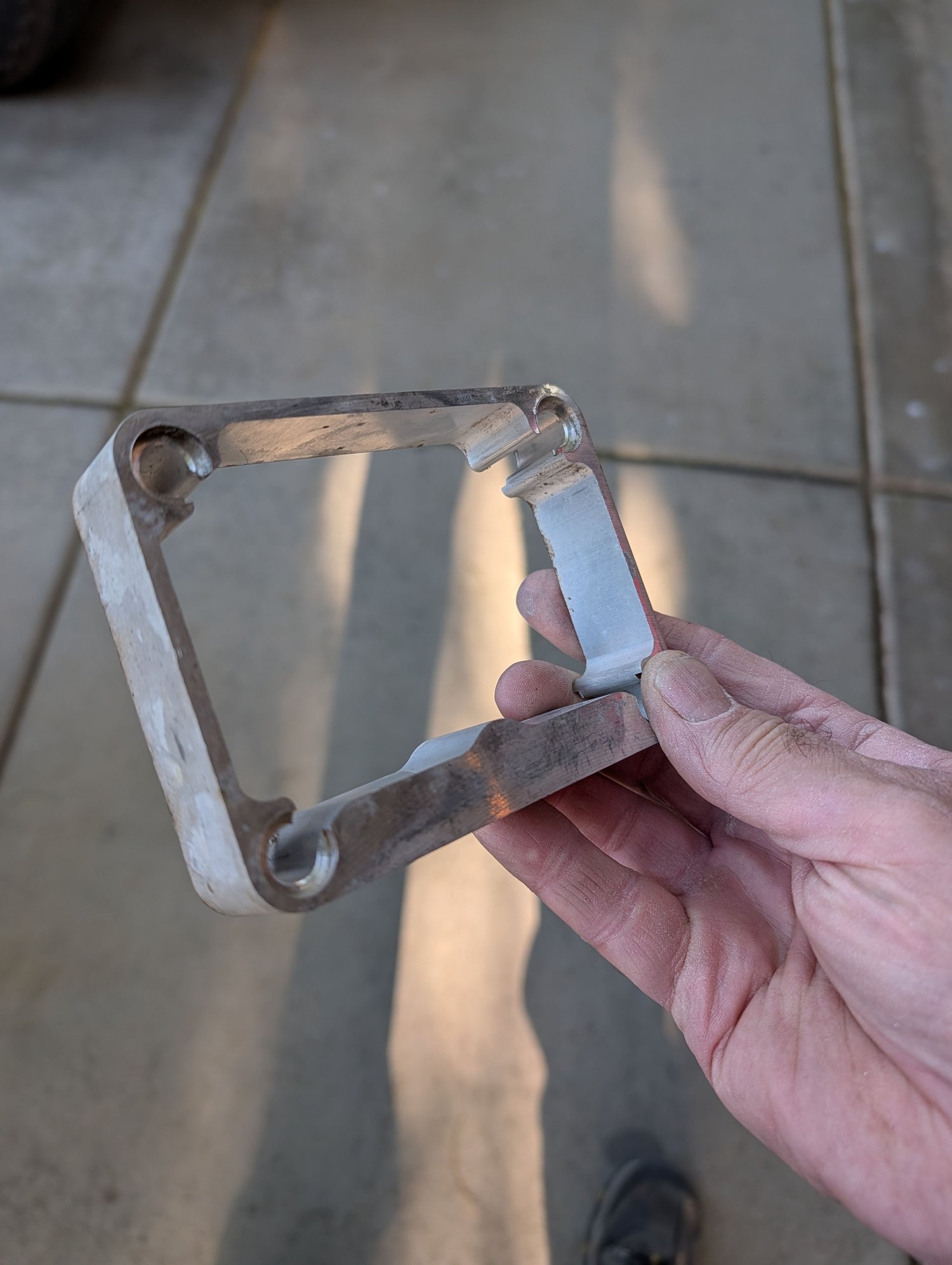

If I remember correctly, there are two different thicknesses of brake booster spacers that came from the factory on these trucks. My 88 2wd pickup has the thicker aluminum one, possibly around an inch thick. Should be a cheap and easy junkyard item if there is one near you.
VOILA.
i estimated the gap to be about half of an inch. I tried some washers that totaled 3/8." The clevis pin slipped in easily, and there was no preload on the booster when I put it in place by hand. I set the pin from the H tool. The brakes work well. I will adjust the pedal a bit higher tomorrow.
edit 4/17: I will fill the gap with automotive strength silicone.
