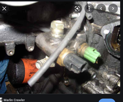

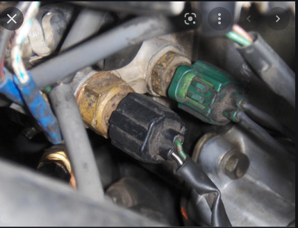

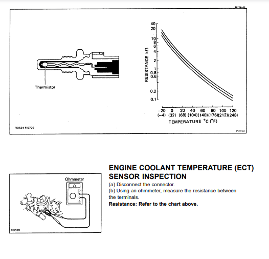

There is a temp sender for the ECU, it is this green one in the front of your intake underneath the throttle body facing forward. Can be tested using an ohmmeter. An air pocket in the IACV can also cause the idle surge you are experiencing.
